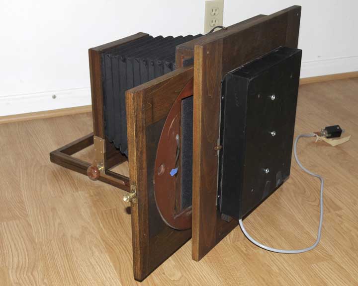

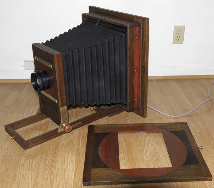

Dan, here's something you might give a try if you have an old camera lying around. It is a purpose built enlarger but is nothing more than a modified camera back with a cold light head. It works like a charm and is portable for my limited space. A 48x60 pegboard vacuum easel is permanently on the wall and the enlarger set up/taken down when needed.

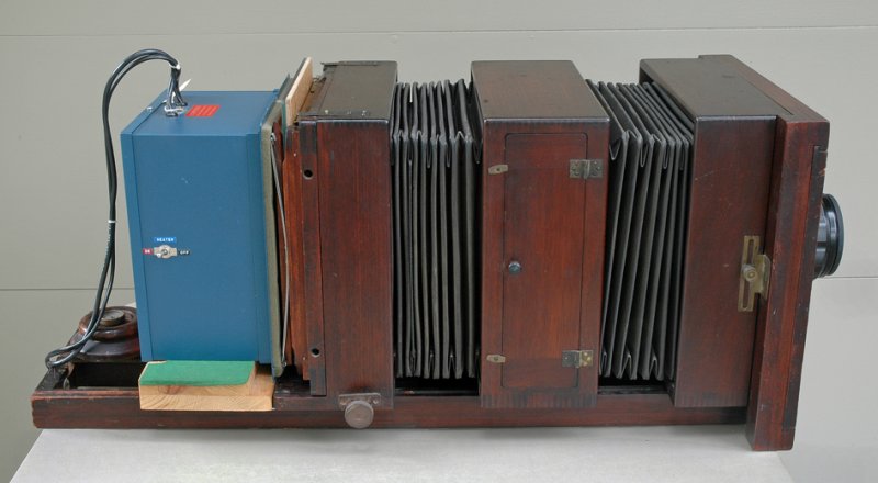

I haven't tried to make a horizontal enlarger but I found this picture of a homemade enlarger. I'm sure there are people out there doing it, AA built his with incandescent bulbs then switch to a cold light head when they became available. The most costly piece other than the lens is the cold light head. Gravity helps with the negative and filters too.

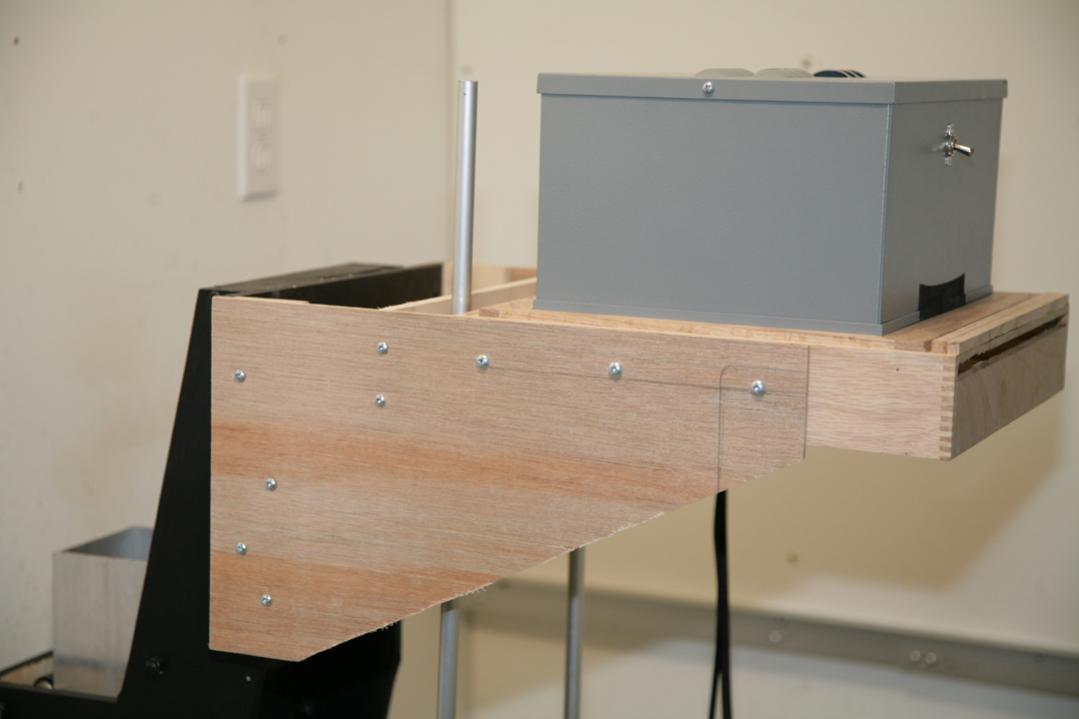

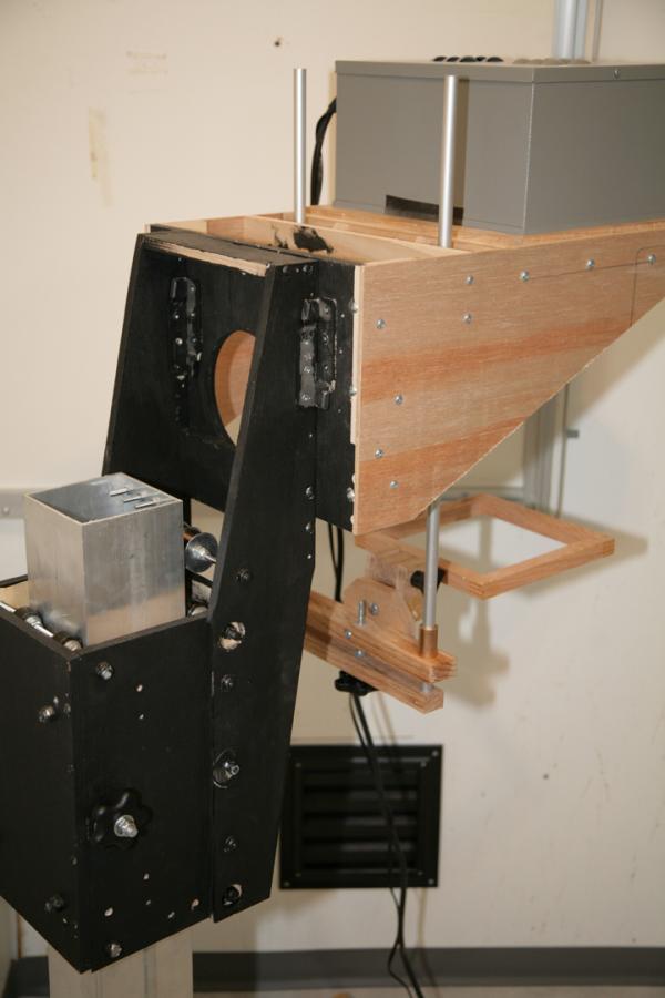

Take a look in my gallery. There are two pictures of a Durst 138S, a 5x7 enlarger, converted to an 8x10. Michael Mutmansky made the conversion. I bought it from him. He used a 12x12 Aristo cold light head instead of 10x10 to avoid fall off on the edges. There is an inch/mm scale beside the enlarger to give you more information. He added two filter holders that swing out underneath the lens to allow for split grade printing FBVC paper. The glass negative carrier is about ¾ of an inch below the light. One glass is anti Newton.

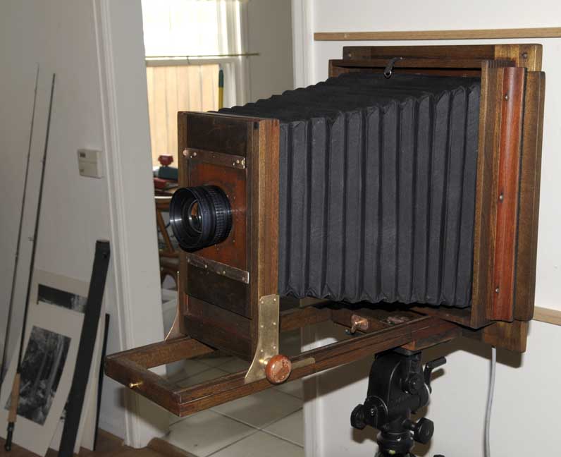

I was in the same boat. I had all these 8x10 negs and the only thing I could do was to contact print them. So I really wanted to get my own 8x10 enlarger. The extremely tight space in my darkroom, about 2.2m x 2.5m, (all of it taken up by sink and existing counter space) meant that the only type of enlarger it could accommodate was a vertical, counter-top one. Not too many of those around for 8x10. So I decided to build my own.
My first attempt included using my existing 8x10 camera as an enlarger head by mounting it onto a vertical column. But the Wisner Traditional is actually quite heavy and wasn't really meant to be mounted facing straight down. Also, I didn't like mounting and dismounting the camera over my head.
So this year, over the last few weekends, I'm building an enlarger head. Here are some photos of the current work-in-progress piece. What's left to do is to make the neg carrier and the bellows and to paint it black. But you might get a better indication of how it's put together with the wood still unpainted.
The only thing I would do differently would be to use 1/4 inch thick aluminum square tubing for the post rather than the existing 1/8 inch thick piece. When the enlarger is at max height, it takes a while for any vibrations to settle down. But on the other hand the current enlarger is very light. I can pick it up and carry it around by myself.

Wow - this is all terrific - just what I needed. I think that the right choice for me is to build an adapter box for a cold light head on top of the 5 x 7 enlarger that I already have.
In case you don't have access to the APUG galleries to see the picture, this is John's fantastic 8x10 conversion.
