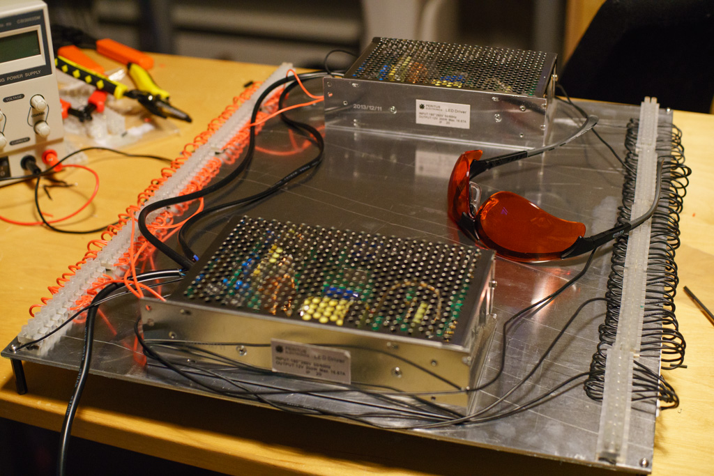

Here's one using UV leds. Getting 10 minute exposure with Na2. It uses 4x 5m rolls of 395um and two 250W power supplies (you could get away with one). The rest was just a bit of soldering, wire trimming and screwing (screws).
