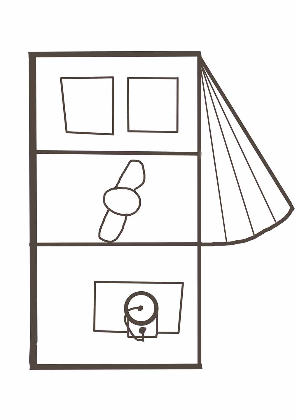

You didn't mention a water source. You should have room for more than two trays. There are tray stackers available that can hold three trays in the footprint of just over one. A number of other goodies and some place to store them. A properly placed safelight. A paper safe in a convenient location may take up too much room in a small darkroom. How small is your room?

Thanks guys, heres a diagram of what I'm working with, I'm putting one or two? 5 gallon tanks up high on the wall, ''its a tall room'' and li get some sort of light safe box to put paper in underneath one of the benches.
thats me standing in the middle just to give an idea of size :smile:.

FWIW, I've never used a paper safe in 30+ years of printing. I would likely forget which paper/grade was in which safe anyway. I keep boxes of many sizes and brands; in grades 2 and 3 for the two graded papers I use (and some 3 and 4 older, discontinued papers) and then a couple of brands of VC paper in different sizes... To much to buy a bunch of paper safes for. Plus, I always know what paper and paper grade I'm using; it says so on the box. The light-proof plastic bags that the paper is packed in gets folded over and the paper returned to its original box. Only rarely have I turned on the white light with a box open and then usually only one or two sheets gets ruined, since they are in their plastic bag and covered except for the opening.
Definitely think about tray stackers and water sources for the wet side. I printed 16x20 in a really small darkroom with two sets of stackers (using only the top and bottom of each stacker; four trays total). It worked just fine.
