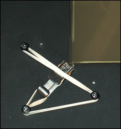

Reinhold, that's what I think I'll do for 8x10 and 11x14, I have a cold light that covers 11x14 and a very clean old wooded camera for the job. I just came in after switching the gears on it. I would be making a glassless carrier since it's going to be horizontal and the film is vertical. Clips at the four corners, springs or rubber bands for contraction. With cold light the negative needs to be close to the light. I would be interested also in your negative carrier and how you case it in between the light and camera back.

This is one way a person attached the film at the corners of a negative carrier.
