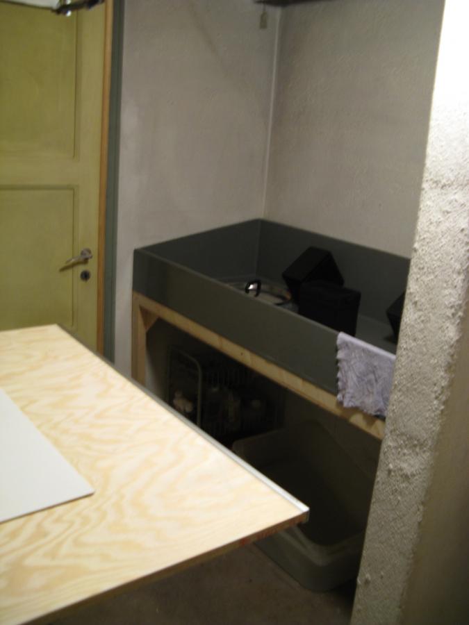

My stand for my sink is 1.5" by 2" lumber. This may be a little on the light side but it was built to go into a tight space. I did drill holes into the bottom of the legs to accept stainless steel nuts and bolts. The hole for the nut is just big enough for it and a smaller hole continues deeper for the bolt. This give me the ability to individually adjust the legs so the sink is stable and drains in the right direction. The bracing is plywood and there are slats at about 30 cm intervals under the sink.
Good luck on yours!

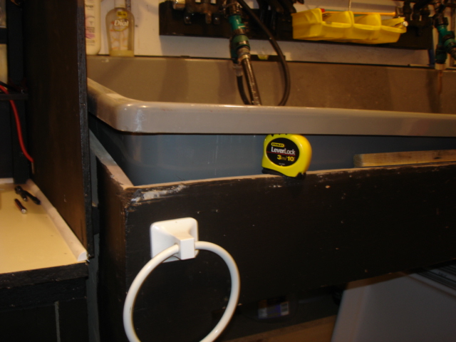

Barry, here are a couple of pictures of my sink base for the same sink. The sink is supported by the recessed edge along its perimeter, which is plenty strong enough to support it. In one picture I propped the sink up with a tape measure so you can see the underlying plywood, which is supported by a 2x4 frame. If I did it over I would build in shelves and tray racks underneath. In the sink is a sheet of plexiglass because I didn't care for the large ridges built into the sink.
I will email you several more detailed pictures.
Mark
