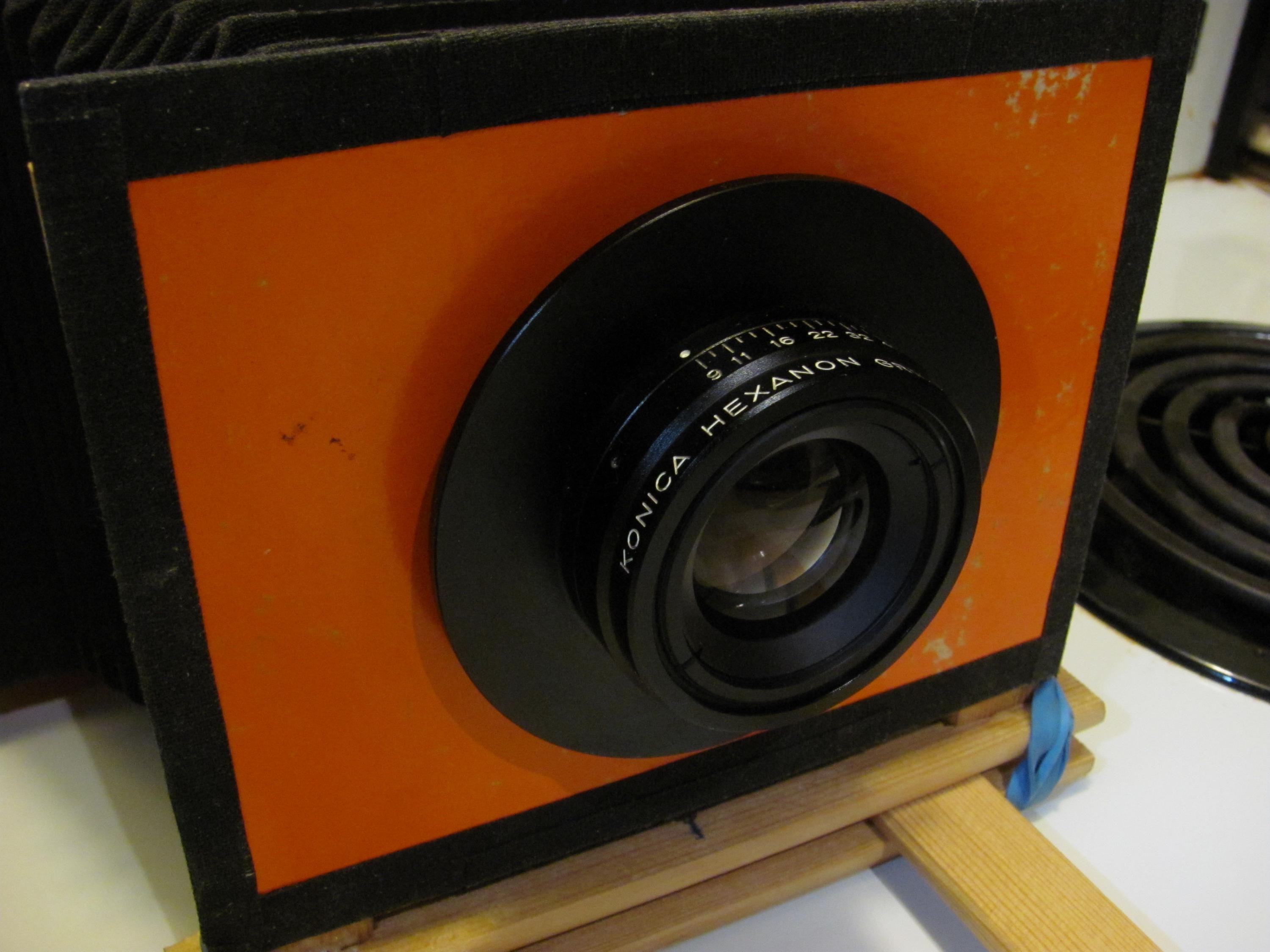

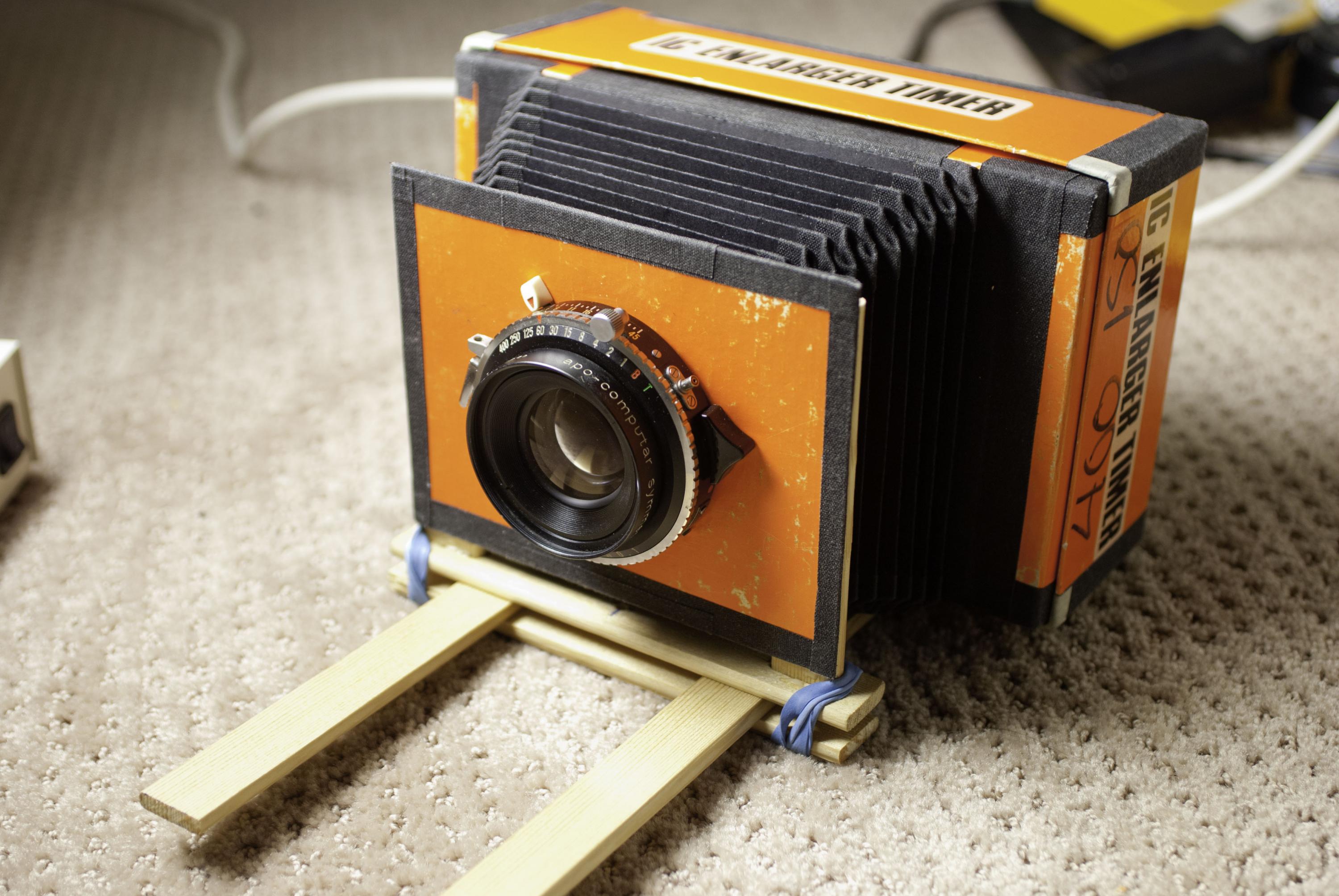

At my school, I'm part of our yearbook class. The position I hold is "Go-To Guy". I take care all the technical problems (other people make! :tongue:). Anyways, one of my duties is to make sure our editors finish sections so I can send them to the press. This involves quite a bit of waiting. So much waiting that I started building a 4x5 camera with the materials I could find in our graphics room. I started it yesterday, and it's almost done!

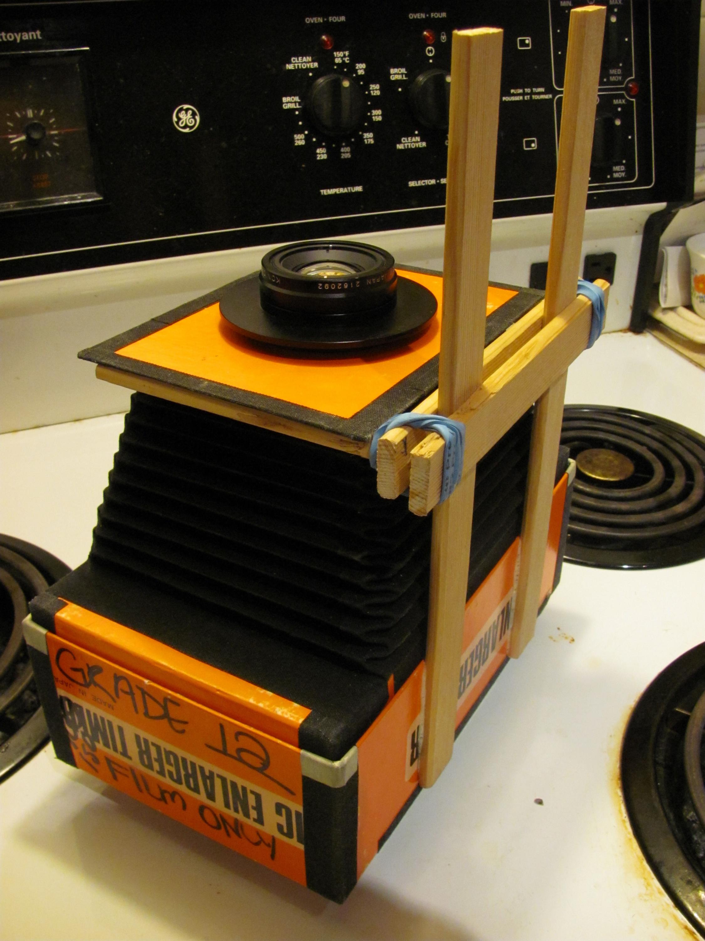

The body is made from the box of an IC enlarger timer, the film cartridge carrier (?) is made from a fuji film box, the bellows are just hockey tape and black paper, and the focusing rails were made with a length of wood and some rubber bands.
As for lenses, my graphics teacher has saved two Konica Hexanon GRII's. A 150mm and a 210mm. I chose the 150 as cardboard cannot support the beastly 210! Unfortunately this means there's no real option for a shutter. The Konica's are great lenses (super SHARP!), but they were made for enlarging. I've thought of making a basic focal plane shutter as there is more than enough room in the camera for it.

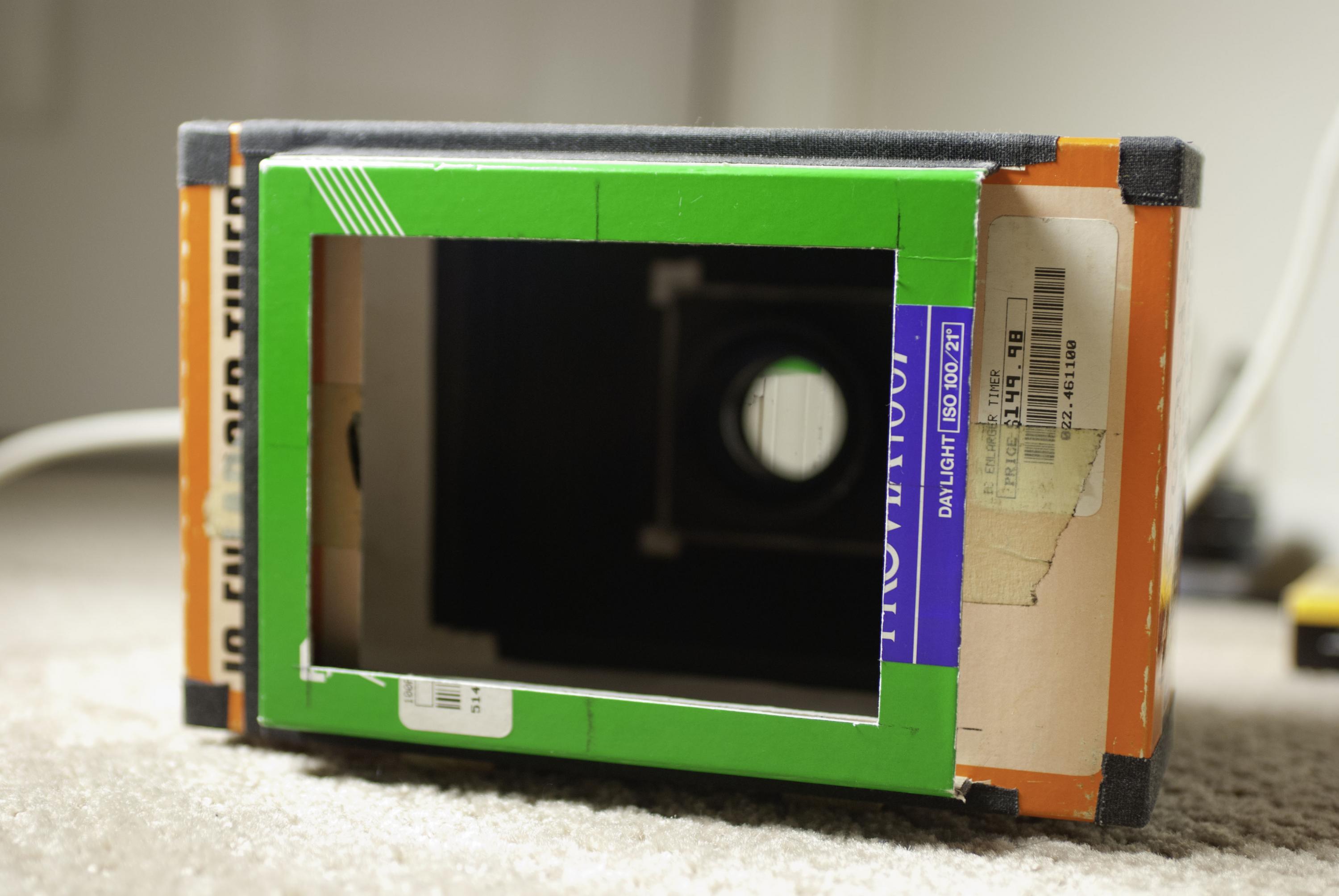

The only things I have left to do is some minor light-proofing and cut the back out of the fuji box so I can add some ground glass.
Finally, here's some pics! What do you think?

Its beautiful.
Stop down to the max, use a slow enough film or paper negatives, and you can use a hat (or lens cap) for a shutter.
Mark the sticks with distance markings and you can use the thing for, er, snap shots.

Seriously, this is great and very inspiring. Do you mind, if I steal the focussing mechanism for my own project? The simplicity is great and it allows for some front swing too, when it's done right.
I also like the back. I always had problems with a mechanism to hold the film holder. Sure, building a spring back is not that difficult, but I also like to limit myself to materials that I already have around: cardboard, glue, various kinds of tape, rubber bands and some random lenses.
How are the bellows holding up? I guess, they're more stiff than usual bellows, but can they be folded and extended without anything breaking?
As for the exposure: You could try to build a guillotine shutter, using either gravity or rubber bands to get the necessary speed. They're similar to a focal plane shutter, as you can vary the exposure by different slit sizes while speed stays the same but they're usually mounted in front of the lens. Wood is a better material, but smooth cardboard (several layers to make it heavy enough) could work too. Calculating the shutter speed with a gravity-powered shutter is pretty easy, but with rubber bands or springs, you'd probably need to guess and test by the good old "trial and error".

@Moki, thanks! Go ahead and use the focusing mechanism. That was actually the biggest problem. I had no idea what to use to focus this camera. Then, I had kind of an "Aha!" moment and quickly rigged this up. Now, I glued the cardboard lens support to the wooden pieces that attach to the rails. What you may want to do is make the lens support more rigid, that way you can drill holes in it and attach the wooden support with screws. That way if you drill more then one hole in the wooden support, then you can move the lens up and down and thus have vertical shift! The bellows are a bit stiff, and a little fragile, but they work well.

About the focussing mechanism... I thought about something like this: http://i239.photobucket.com/albums/ff252/mogul-/temp/mech_focus.jpg
The red things could be either pieces of wood or very long screws. They're attached to the bottom board while the top only has holes and can move freely. It's all held in place by the blue rubber bands and a little friction. Now you can just insert the lensboard (drawn grey) between those four screws (be sure to make it fit tightly) and can move it left to right or up and down if you put a little stopper underneath it.
That's probably a bit too much for your current materials... it's just the idea that came to me when I thought about your very simple mechanism. I think, that's actually the easiest way to have basic movements (except tilt) in a camera. I'll definitely try this some time soon.

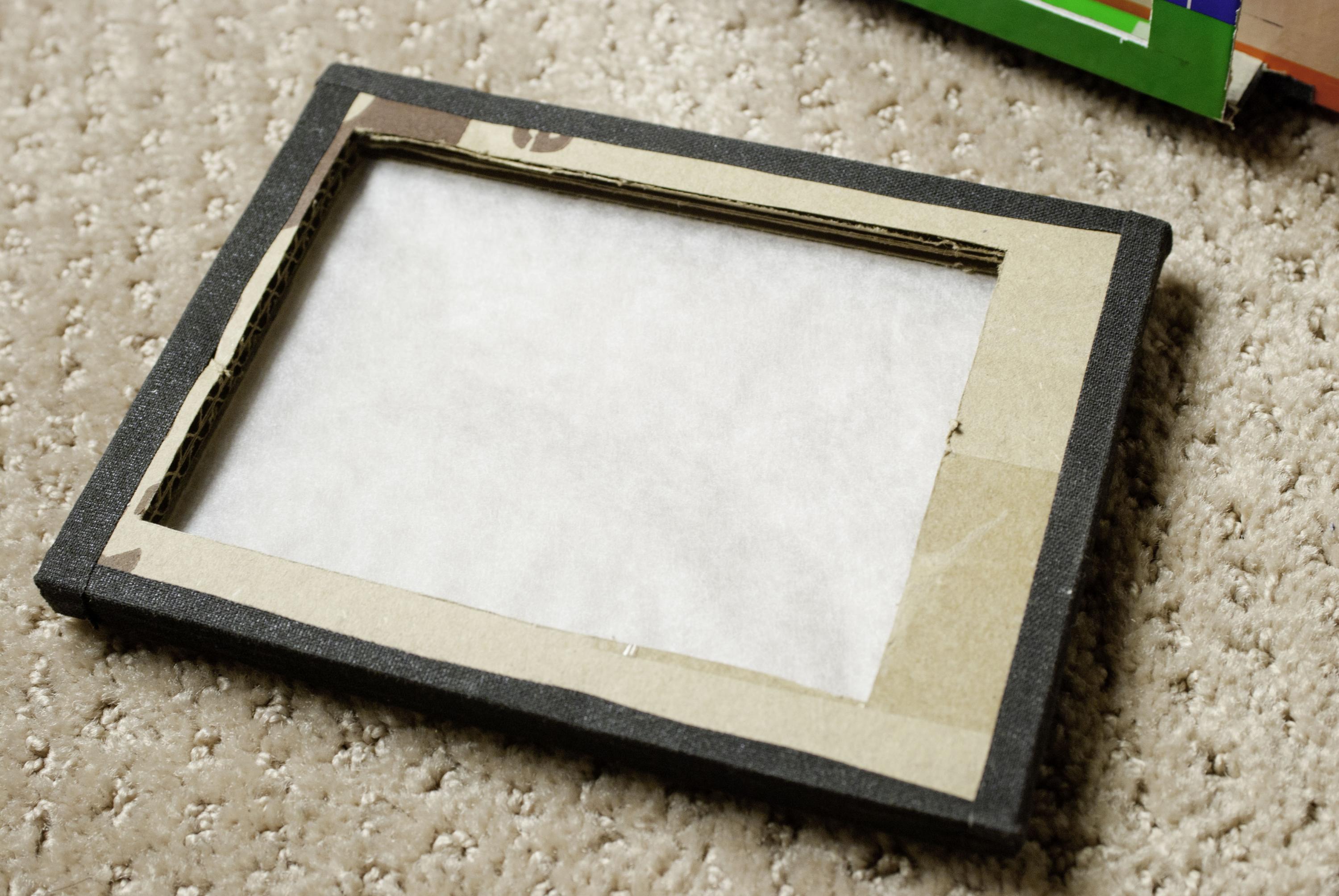

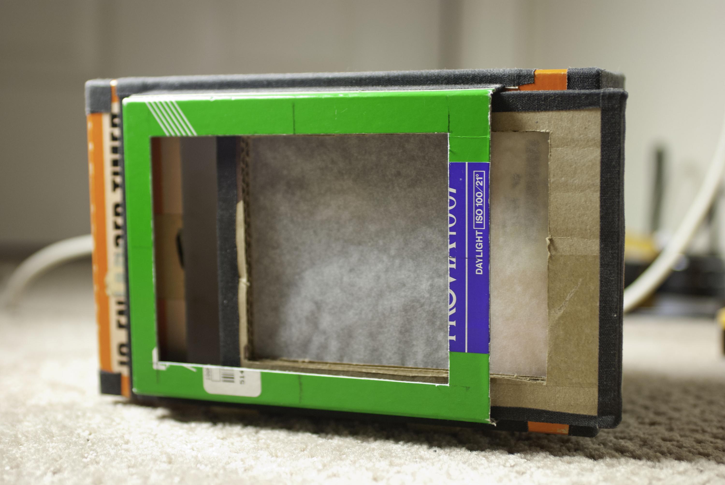

Here are some more pictures. As you can see, I've cut out the back of the camera. That way I can put in a "sudo" gg to focus. This gg is made from just cardboard and tracing paper (again, stuff from the graphics room). I can almost guarantee the gg is off by a good bit, but it's better than shooting blind! You'll also notice a different lens. I took this lens from our school 4x5, it's a 150mm computar symmetrigon. Not a great lens, but okay. I intend to use it until I build a shutter for the konica or until my graphics teacher notices the missing lens! :D

Lovely job! Very straightforward, very resourceful. I am worried a bit about the Fuji box back, though: sure looks to me as though it's going to be a massive light leak around the end of the negative carrier. Perhaps some felt or soft foam might help. Surely there's something they use in hockey which would be perfect? :wink:

I just need to get myself some felt for light-proofing. Then I'll scan and upload lots of stuff!
