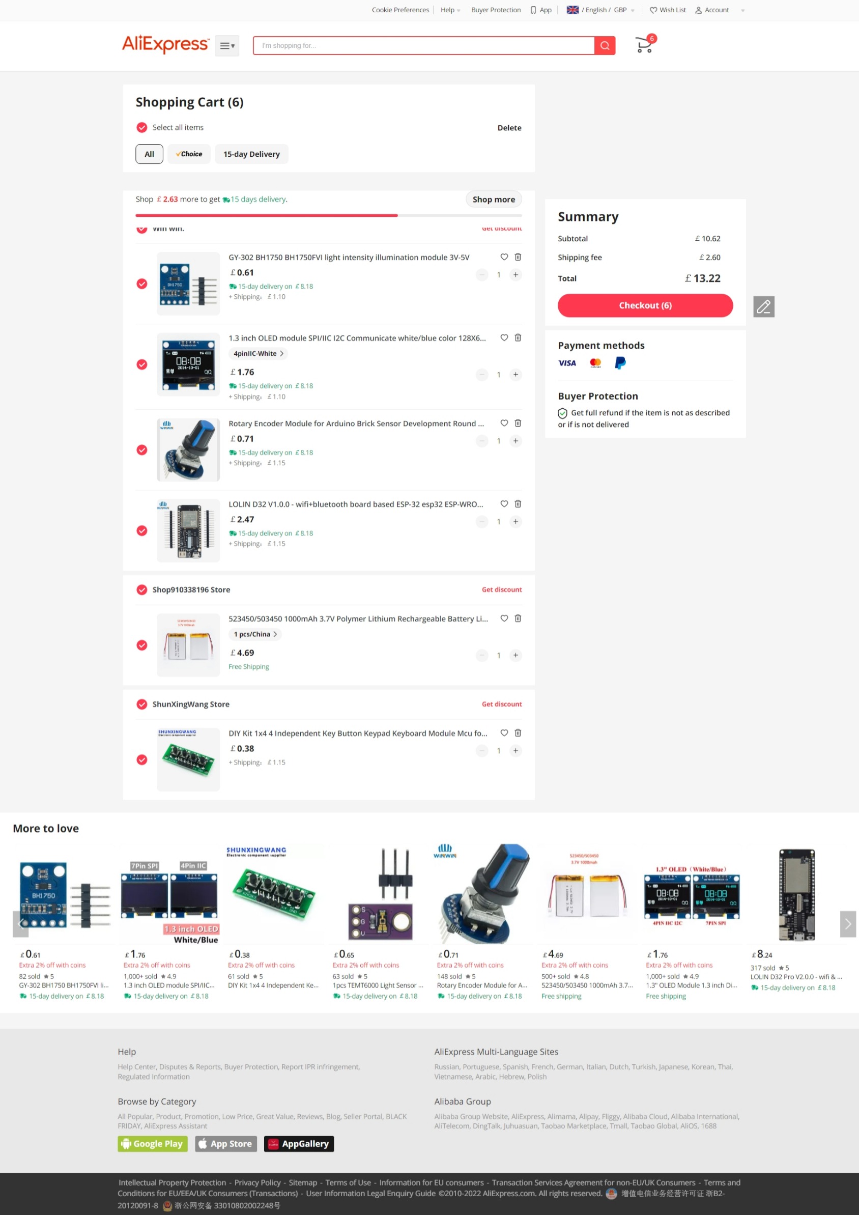

Below are the parts required. Total price, excluding a box is £13.22
If buying from Aliexpress, try to get as many parts as possible from the same webshop, as hitting the magic £8.18 gives faster shipping.
Sourcing from local suppliers in your home country will of course arrive far quicker, but slightly more expensive.
I have shown a block of four push-buttons. Currently only one is required. The project may develop, requiring more buttons. You may wish to buy a one, two three and four button module.
The oled MUST have a SH1106 driver chip. The sellers description in my list does not specify the driver (some webshop ads do) but the reviews do say it has the SH1106 driver. It must also be the four pin IIC (not 6 pin SPI) version.
The encoder below with a round pcb is a better design than the more common ones with square pcb, as it incorporates RC filtering to help eliminate switch-bounce.
A word of caution with the battery. There is no standard for how the connector is wired & the polarity may be reversed, compared to your board. BEFORE plugging in the battery, ensure the polarity of the battery connector is correct.

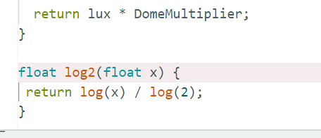

It complies ok on the Nano, but not on the ESP 32 & I can't work put why. Error message and code segment below.
I have changed the oled to the SH1102 iiC & removed the battery check code.
Removing the bad lines below allows the code to compile & it is running here now.
Another issue us that it is not saving data to eeprom, it always starts at iso 8
Edit - of course on esp32 one has to add the line EEPROM.commit() after eeprom write. Doh :surprised:)
updat -updat - have added EEPROM.commit(); and it still does not work :surprised:)
Using library EEPROM at version 2.0.0 in folder: C:\Users\\AppData\Local\Arduino15\packages\esp32\hardware\esp32\2.0.9\libraries\EEPROM
exit status 1
Compilation error: 'float log2(float)' conflicts with a previous declaration
koraks
Nov 29, 2018
26,130
Europe
Probably because log2 is a pre-defined function/macro in the C++ version that's used by the ESP32 core. The default Nano core uses a different compiler, so these kinds of issues tend to pop up from time to time.
You could try simply commenting out that entire function declaration and see if it works OK.
Or just do a find/rename on all those names and replace them by something else.

Yep, I commented out the offending two lines & it runs ok.
