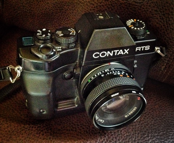

I began the day with good intentions. I was meeting a kijiji buyer for my Olympus XA-4. With cash in my pocket after the sale, I chanced upon a private deal with a camera store clerk. He was playing with his Contax RTS III (with Zeiss 50f1.7) when I entered the store to see about buying some film. I asked if the camera was for sale and he asked what I'd offer. He explained that he bought the camera personally from a store customer for $50 because the camera store does not buy up old film cameras anymore. He just wanted to set it his display shelf at home. I offered twice what he paid and he accepted. He then brought out a bag that the camera came with. It contained a Contax flash, Zeiss 40-80f3.5 zoom, and 2 Tamron lenses, 28 and 80-210.
I don't need any more cameras but I could not pass up this ultimate Contax film 35mm SLR with a couple of Zeiss lenses for that price.

Film is loaded. Everything seems to work except the exposure counter. Both the top deck LCD and the viewfinder display read 00 and do not change. I can say that this is an example where a new piece of gear motivates photo juices. I've been very lazy with film photography lately.

You might need new batteries if that's what you're getting. IIRC that's the low battery warning. Either that or the camera thinks the film isn't properly loaded - Open it in the dark and check to see the film take up spool has caught the leader. But first try a new battery. If you're not going to use it often, then get the lithium 2CR5 for it. You'll be limited to a 2.5 fps on the motor drive (probably not a big deal) but you'll save yourself horrible heartache if six AAs go bad, leak and corrode inside the battery compartment.

Thanks for that Scott. The low battery indication is an icon of a battery half filled in and it's not visible. I loaded a roll that came from another camera with just a few exposures on it. The leader was badly curled so that might be it. I'm going to try a fresh roll after thawing it from the freezer. The lithium battery is a good idea.

The contax flash was like that. Had to force open the door and found the batteries had leaked. The top contacts were gunky but only one of the bottom springs was fouled. I'm hoping that vinegar cleans it up.
Good news. I removed that roll of film, cut off the curl and recut a leader. Film counter works when the film is loaded properly! :smile:

Another fix: The camera was missing the viewer eyepiece and the threads for same were bent. I straightened (or rounded actually) the threads and found that my Nikon F4's eyepiece fits and screwed in. This will protect my eyeglasses from scratches. :smile:
