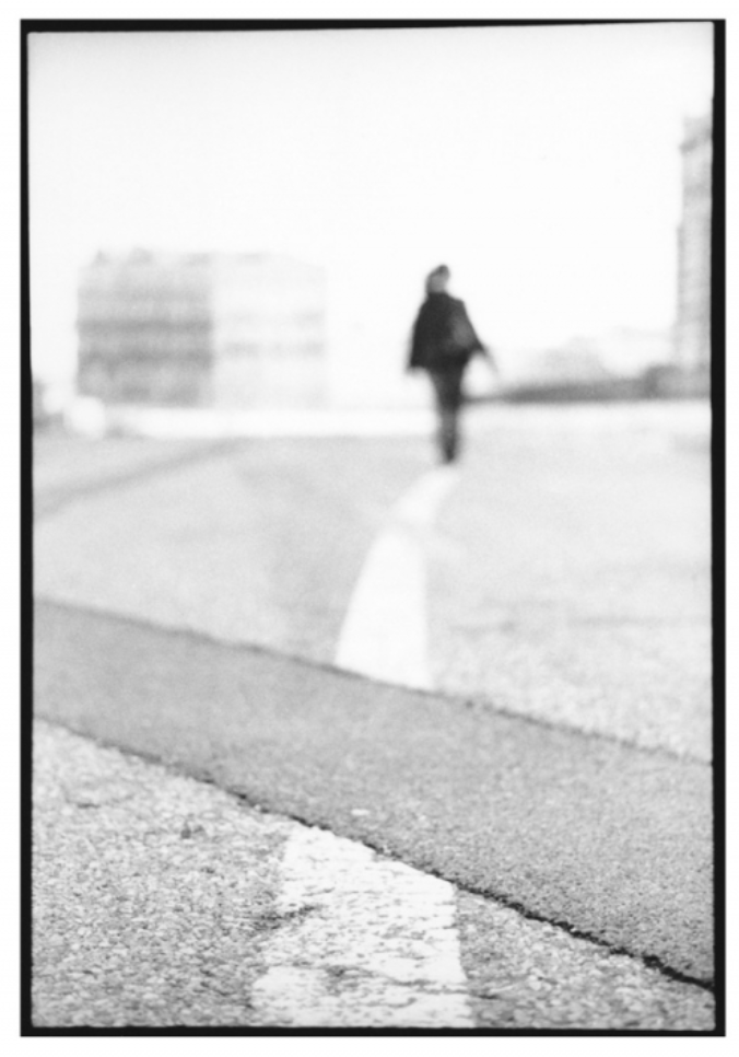

Ok, let's try to isolate. This frame doesn't have anything else going on than some optical. The front is pretty sharp but the unsharp figure has some strange bokeh going on. Could this be a bad lens? Tilt shift?
koraks
Nov 29, 2018
23,247
Europe
Honestly that example just looks like any run-off-the-mill 50mm lens set at its widest aperture and the focus chosen on a point pretty close to the lens. Nothing more, nothing less. Then just smacked the negative into the enlarger or onto the scanner platen and Bob's your uncle. Yes it could be done with tilt, but it doesn't look like it in this instance. I also don't see anything special about the out of focus areas (bokeh). Just pretty overexposed since exposure was based on the darker foreground.
Ok, I have to try myself. Maybe it is the overexpose of dark figure on bright makes the blur a bit "special". He has some other photos that have some similar "thin" blurs and that is why I asked.
