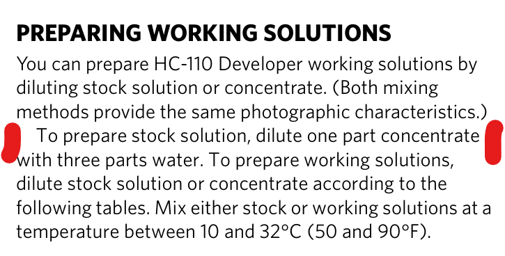

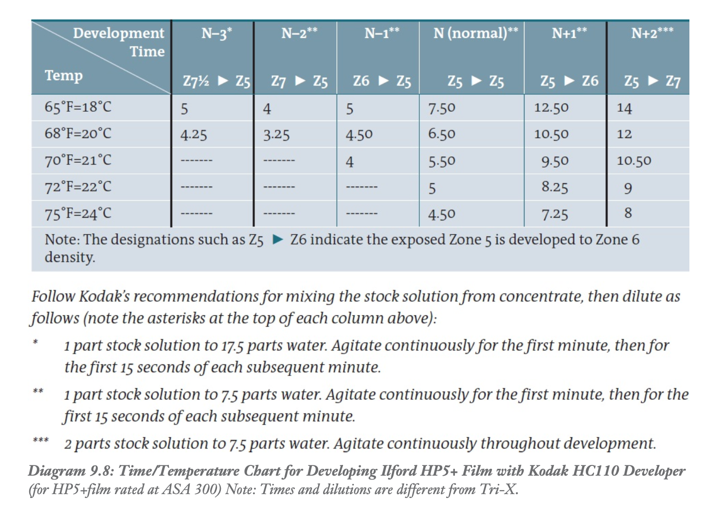

I've been reading Bruce Barnbaum's "The Art of Photography (2e)" and am eager to try his HC110 development recipe for HP5+400 (35mm).
HOWEVER, I have been unable to determine the stock solution that he uses for HC110 development. It seems all of the development instructions/recipes call for a specific dilution of the stock to create a working solution, but I cannot find anything in the text that actually states what the stock solution is...
I was wondering if anyone knows what Barnbaum was using for a stock solution in the examples he gives in the book?
Is he just diluting from a 1:31 Dilution B stock?
