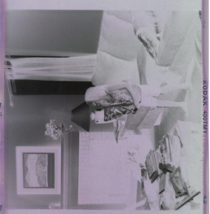

About 14 rolls fixed, but hard to tell since I did some 12 exp color as B&W through it and some cut pieces of 35mm used in a pinhole camera. I scanned part of the film, see below, and it looks more purple than brown on the edges now that it is dry.

From the color purple I strongly suspect that you need to wash the film longer to get rid of the purple cast and then rinse in PhotoFlo. After that you may have found that the brown stain has left the negatives.

TMax is tough on fixer, so is color, because there are three layers of silver halide instead of one.
You should re-test the fixer, but it looks to me like the negatives may be under-fixed, possibly under-washed too because of how much purple dye is at the edge.
You need to test the clearing time each time you process. If a piece of leader isn't convenient, open the tank at half of your normal fix time and see if the negatives are cleared. If they aren't, monitor every minute or so, then give them that amount of time again. That time is what you start with the next time you process.
When your clearing time is double what it was when the fixer was fresh it's time for a new batch.
You also need to refix your film with fresh hypo.

I put it back in the fixer and the edges were clear when checked at 1 minute. No purple either after rewashing. I think I will start over with some fresh fixer next roll. Lesson learned on testing each time. One extra question. How many rolls can your average fixer last? When I first started buying chemicals the opinion was odorless did not last as long as regular rapid fixers and would only last for 20 rolls. If it is only 4 rolls as pentaxuser suggests, fixing would get expensive real quick (~$1.50 a roll with the cheap stuff).
