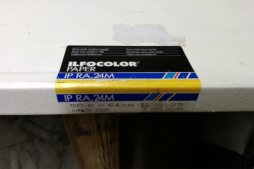

Thank you! Yes, I do mean Scott. I just learned last night -when I got the hankering to listen to the podcasts- they are unavailable ANYWHERE as Iandvaag stated. :sad: I wanted to to "curl up and die" as we say in the South. :smile: I can't believe you use Ilford! Gadzooks, Batman! :D I wish Ilford made a C-41 film. Their black-and-white is just phenomenal. And it should be, that's all they do.
On a side note... just a couple of years ago I was fortunate enough to run into some awesome chick on Craig's List here in Chattanooga that was wanting to sell a bunch of paper and darkroom equipment she acquired. In that stack of paper was a box of (16x20 or 20x24) Ilford RA-4 paper! It's metallic, I believe. I tried to make a test print but that sucked. I had no RA-4 at the time and used C-41 haha. I got results... The paper seemed to still be in usable condition. Hopefully I will find out in the next few weeks, as I am getting my darkroom setup for use! XD
Hmmm... talk about a rabbit trail.

I could be just absolutely wrong whether this is RA-4 paper, but it is Ilford color paper :smile:
