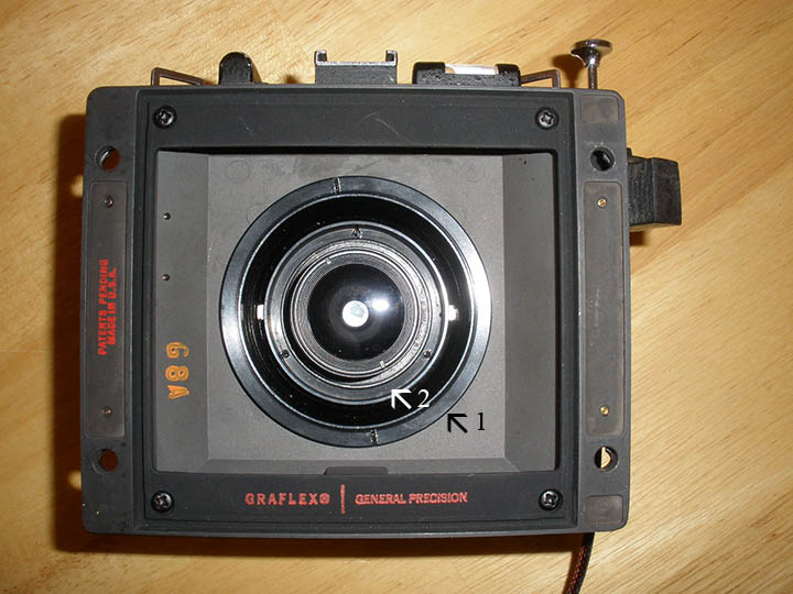

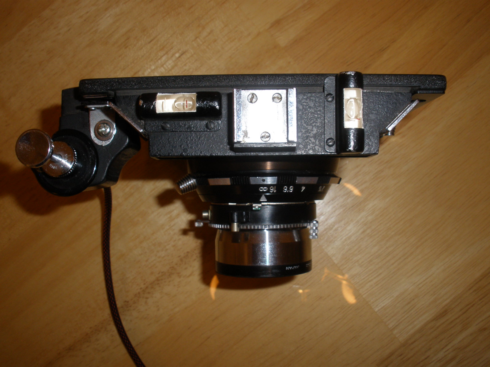

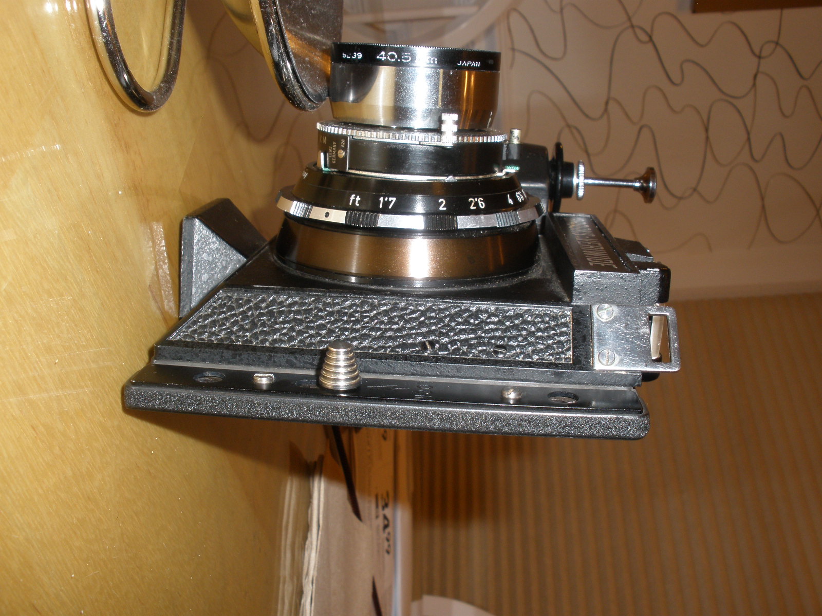

As suggested, here are some pictures of the camera. The problem is that the lens is loose in the mounting, it wiggles and you can turn the lens around and around and around. The camera is badged as a a Brooks-Veriwide, yet the back of the camera body clearly shows Graflex. I does look different from a Graflex XLSW.
Thank you for your responses. I hope this posting adds more clarity to my issue.

Well, this is definitely not a modified Graflex XL. The difference between a Synchro Compur and a Graflex compur is the name/trim plate.
Black arrow 1 is the lock ring for the focus and rearward, White arrow 2 is a lens board mount flange. Both should be tight.
In your 4th picture the shutter appears to be cocked slightly at the aperture indicator. This suggest this is not the correct lens/shutter combination for this camera and someone just slapped this one on the camera or shims between the shutter and focus mount are missing.
SK Grimes will be able to correct the problems and they may be pricey. I would email them the pictures and ask for an estimate.

The Brroks Veriwide was assembled from parts of cameras made by other companies, ie. Graflex. This one appears to be the ame as mine which is original inall aspects. I am wondering if soeone dismounted the lens and lost, or forgot to replace one or more shims when remounting.

OP, thanks for posting the images. They added much clarity.
There's a manual for that camera, miscataloged as for the Veriwide 100, at http://www.butkus.org/chinon/brooks_veriwide_100/brooks_veriwide_100.htm. It shows the camera with a Mamiya Press roll holder, whose gate is ~ 56 mm x 82 mm.
I don't agree completely with Shutterfinger's comments in post #6 above. I agree with his comment that his black arrow 1 points at the lens cone's retaining ring. I don't agree that his white arrow 2 points at the shutter's retaining ring.
I b'lieve that the shutter's retaining ring is hidden behind the lens' rear cell. To find out, unscrew the rear cell. There should be a slotted retaining ring.
If I had the thing in hand and my guess (educated, but still a guess) is right, I'd use a spanner to remove the lens cone's retaining ring, would then remove the cone from the body. After that, unscrew the lens' rear cell, remove the shutter's retaining ring and remove the shutter and front cell from the cone.
Shutterfinger's comment that the shutter is canted on the cone points to a mounting issue. Many of these shutters were delivered with a tiny screw protruding from the back. This screw was intended to fit a slot or hold on the lens board. When mounted with the screw in the slot/hold, the screw will prevent the lens from rotating on the board. When mounted with the screw anywhere else, the shutter will be canted on the board and may well turn freely. The only way to check is to disassemble as I suggested. If this is the problem, reassemble with the screw in the right place.

If I understand the thing correctly, it is a simple DIY job.
