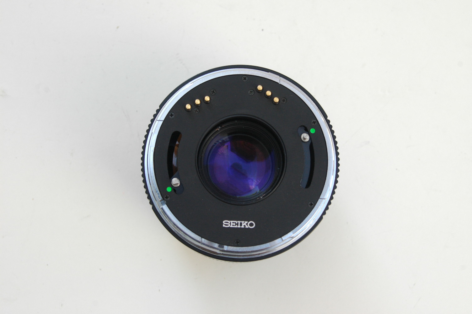

This is something I've been thinking. I checked the contacts and they appear in normal condition.
The pins on the lens are fixed. See below.

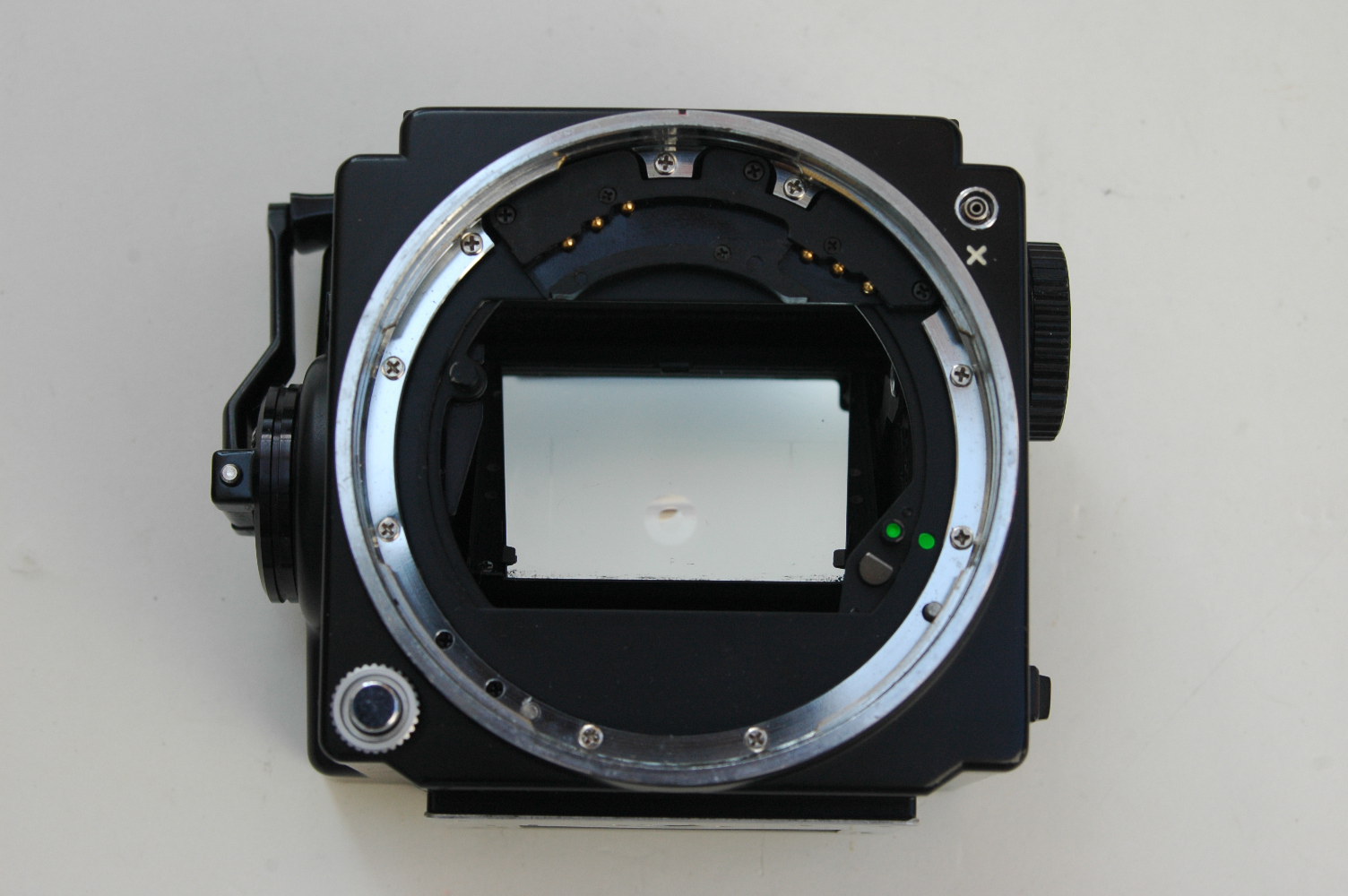

The pins on the body are flexible, with springs in the back:

Both body and lens look in great shape, not messed with. This has to be something with the electronics or the contacts.
