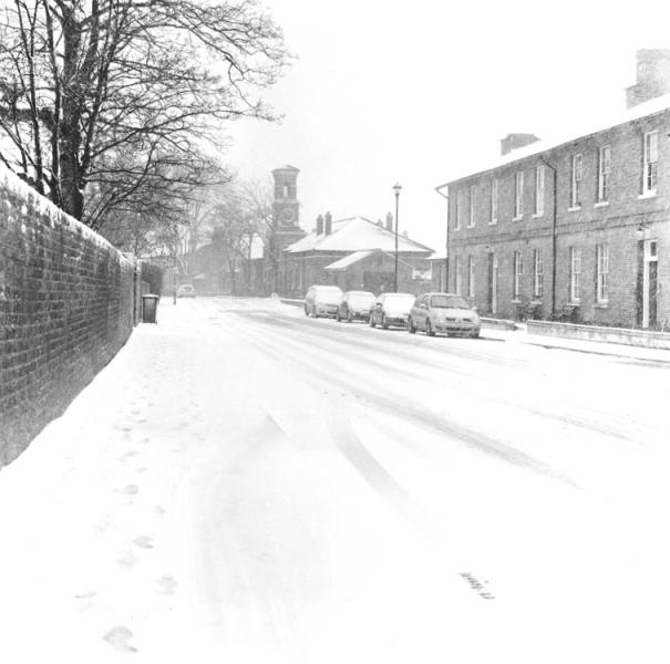

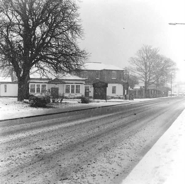

Developed and printed a couple of rolls from my Bronica last night. It appears one of my film backs may be leaking light.
Here are a couple of examples from last night's enlarging session. As you can see, they are markedly lighter at the sides. This suggests the light is entering at the point the back mounts to the camera body... but then I'd expect lines across the negs too... so it could be getting in around the film loading 'door'?
Any ideas on how to solve this?

Tom, I can't scan film. In the attachment showing the pub you can see the print shows a 'lightening' towards the sides. This leads me to think light is getting in around the film loading door of the film back. I was wondering if one of john Goodman's kits would solve the issue.
