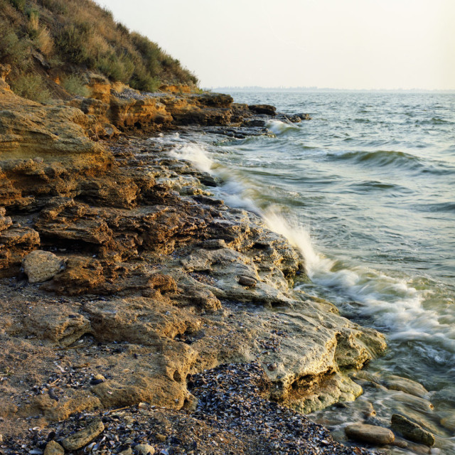

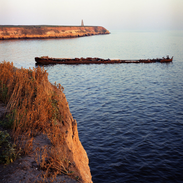

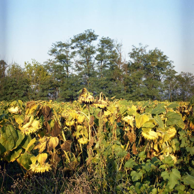

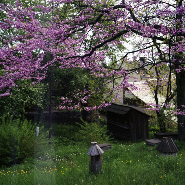

I recently bought Bronica SQ set (including Zenzanon-S 80/2.8 , AE metering prism and 120 back).
First roll revealed some problem - dark "stripes" along the edges of the frame.
They can be seen on the exposed area of negative only, not in the spaces between.
Since it was an expired film, it is possibly damage of the film itself.
s640x480
However, on the next film rolls, problem still exist, altough not so obvious.
Here it is on the right side - looks like vignetting along the edge of the frame.
s640x480
Here it is less prominent, on the right side too.
s640x480
I thought it can be a light leak in the back, but light leaks usually appear like light stiripes, not darker ones, right?

Take a picture of something out in the open sun, casting a shadow, make sure the sun itself is also in the frame.
Now what would you say would be light(est), what would be dark(est) in the picture? :wink:
And/or take a look at the pictures the OP posted.
See how, for instance, the shade below the sunflowers is darker than the nutated sunflowerheads, and ask yourself whether that really would be because the film receives more light coming from the shades. :wink:

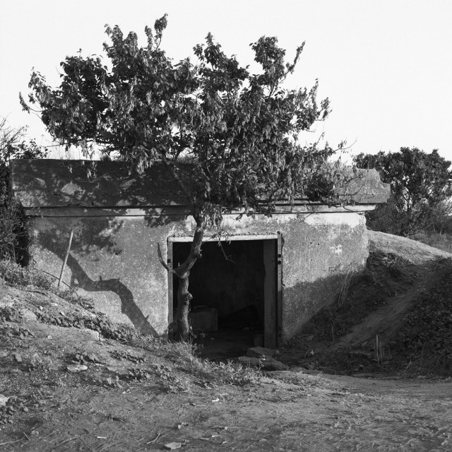

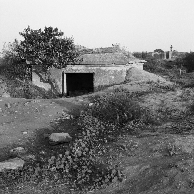

I developed Delta 400 myself - no such artefacts:
s640x480
s640x480
it seems a lab processing issue. unfortunately I cannot change lab, becouse there is only one in our city, capable to develop C-41 MF film
