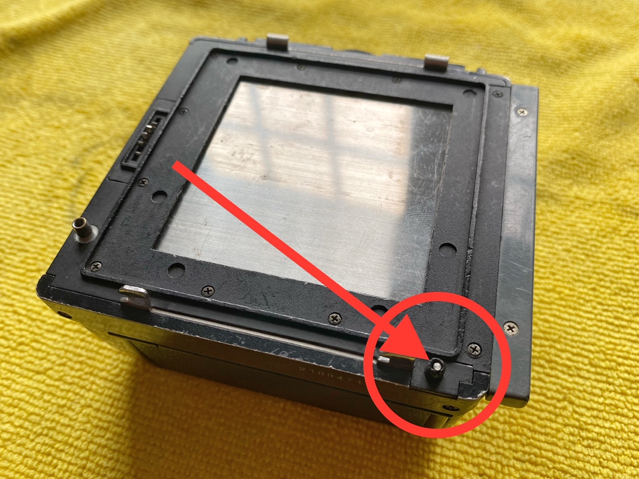

I have a fairly ugly film back that I wouldn't be opposed to attempting to file down the interlock pin as I've read that's merely what Bronica Technicians were doing when customers were experiencing similar issues. I don't know if that's true, but in my research it has seemed to remedy the situation for some people. Should I go for it?
There are two pins with collars on the film back, the one pictured below circled in red is the one I believe to be the Interlock Pin can you confirm?
Thanks again for your time and help, I really appreciate it! What a mystery!
That pin is the darkslide interlock, so the body knows the shooter screwed up and is trying to make an exposure with the dark slide in place. You can verify that action simply by removing the darkslide and watching the pin withdraw.
(Note: If the back has a darkslide lock to prevent users from removing the slide while the back is not mounted on the body, there is a very small pin close to the darkslide handle that you have to depress first to pull the darkslide out).
The other pin, close to the film advance gear, is the film advance pin. If you put a roll of film into the back and advance it, a pin should rise to indicate back is ready for next exposure. I would NOT file it down too far...do it progressively. And I would use a fine grinding tool in the Dremel, not a file, to remove material off the end of the inner pin (not the outer sleeve)
This particular Film Back doesn't have that pin, but the other two I have do.
Thanks for the descriptions! Very helpful! I think I'll continue researching before I pull any tools out and modify anything as it cannot be undone and I'd prefer to be sure before altering anything physically!
