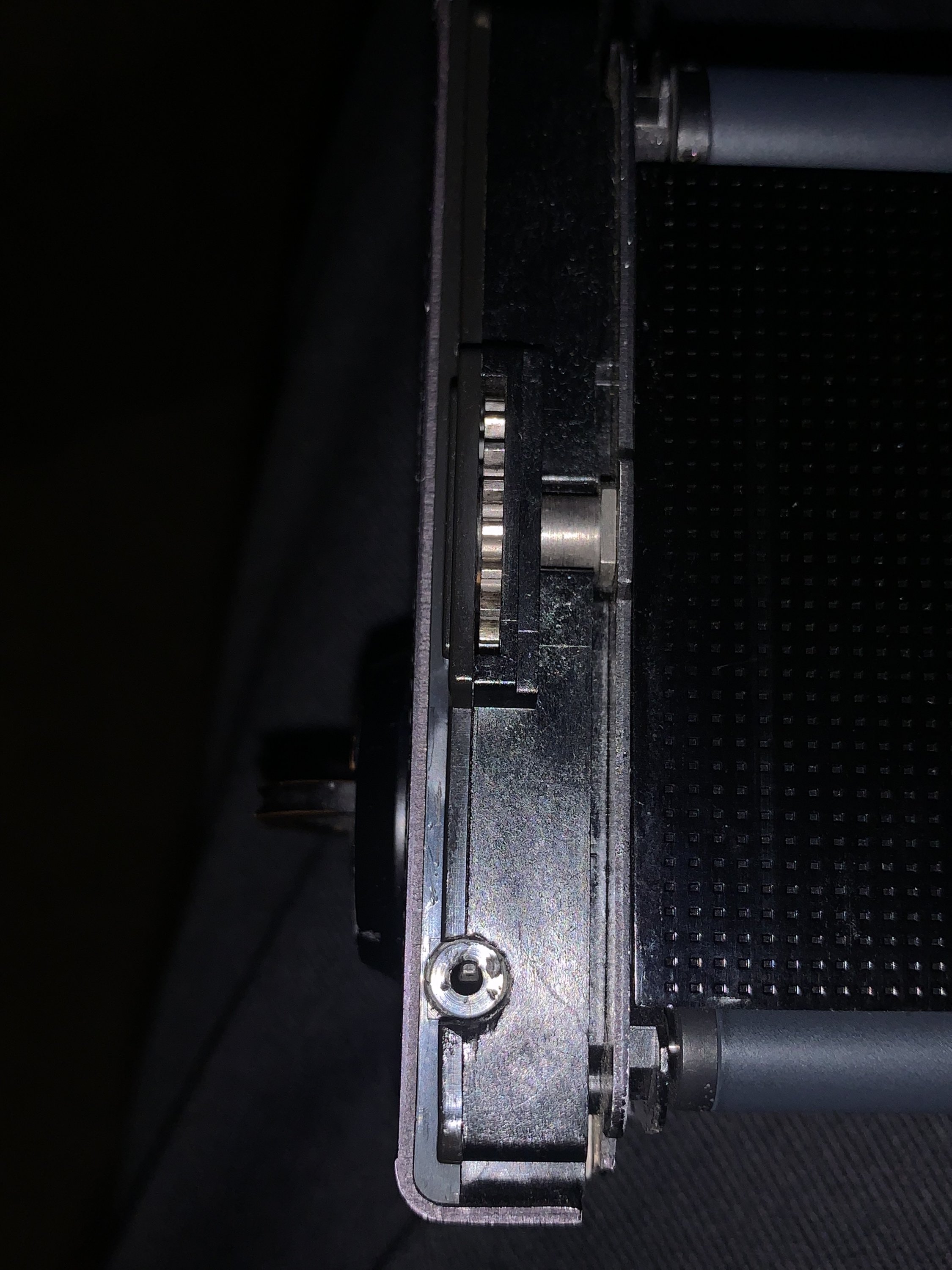

Upon further inspection, i've just found this pin to not be straight. I don't think its making proper contact. Is this the interlock pin?

I cannot say with certainty, as I do not own SQ (I own ETRSi bodies), but I would make an educated guess that the illustrated pin is the film-advanced interlock (same side as the film advance gear).
You need to try a different back, to eliminate the possibility of a misadjustment within the body...same behavior = need to adjust body; different behavior (than your back) = neet to adjust your back.
If sending somewhere for repair, you need to send both body and back so that adjustment can be verified. I had to send both body and back to GMI Photographic (Bronica distributor before Tamron purchased Bronica) to adjust a used back which I had purchased and which intermittently malfunctioned.

G'day there. Had it in single shot mode the whole time. Loaded the other back with a roll the same way and had no issues. I think the back might be toast :sad:
