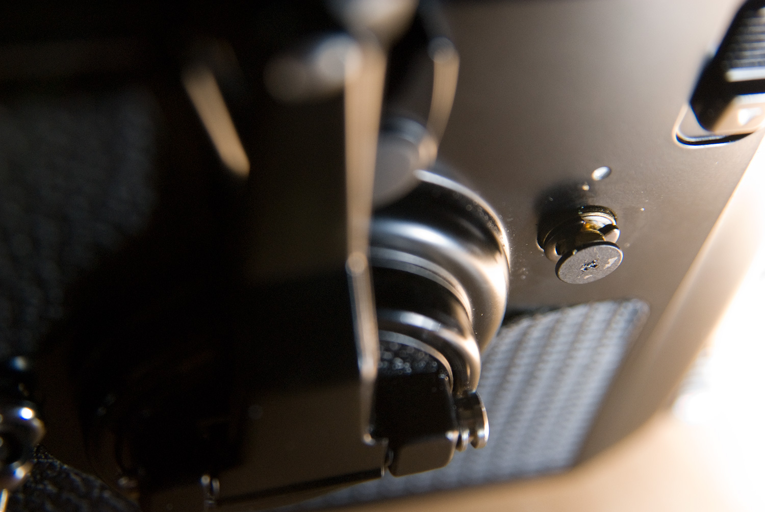

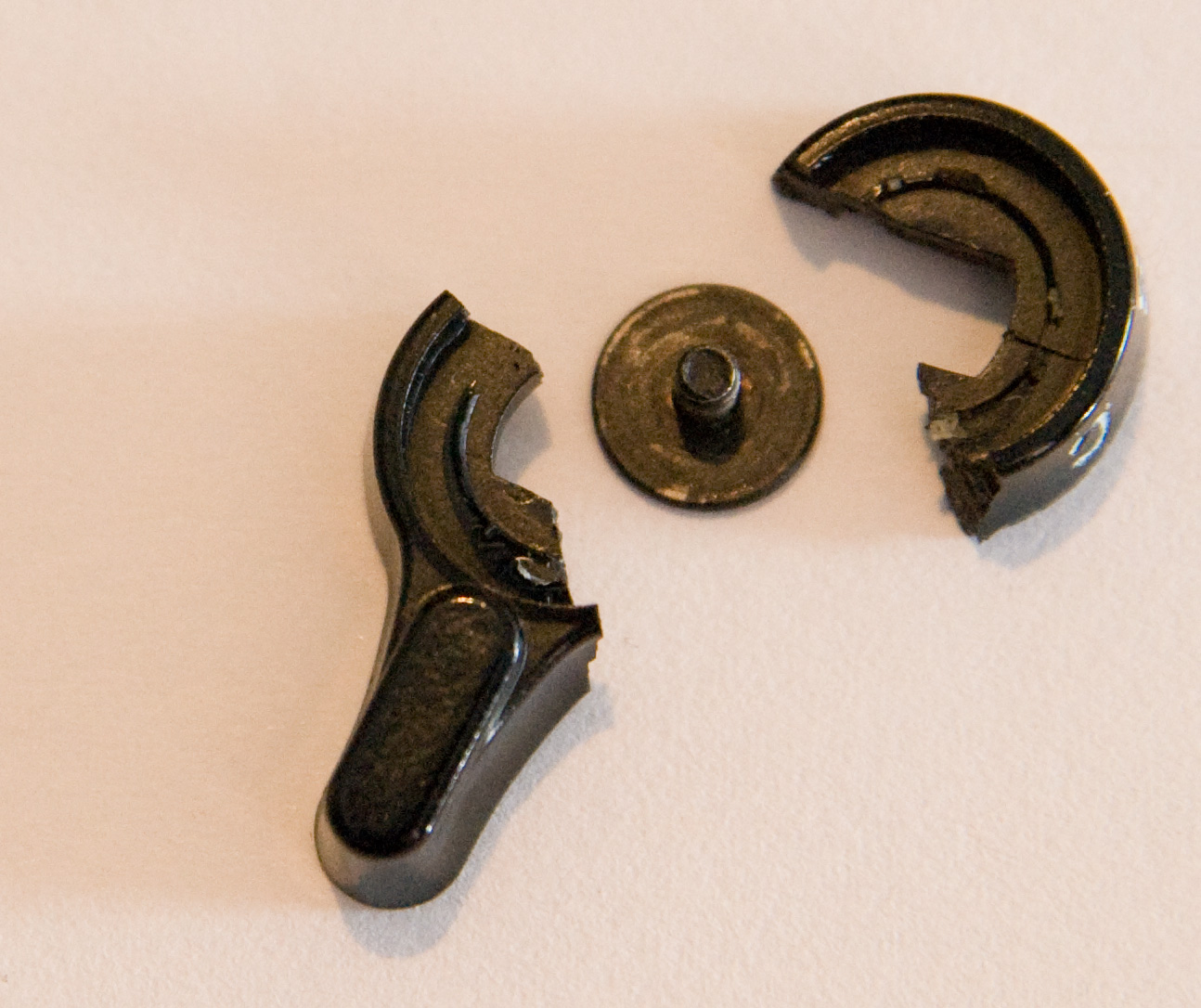

This afternoon as I was working with my SQ-B camera I suddenly noticed the shutter wouldn't fire; looking down at the camera body, the plastic lever connected to the mirror-lock-up mechanism had broken, and then fallen off.
If you have experienced this issue, did only the lever need replacing or was there a more underlying fault?
I'm guessing the replacement tiny plastic lever will cost £50 ...
EDIT: I should add the shutter does appear to fire in the non locked-up position, but I've not put a test roll through yet.
Tom.

Does the lever (or shaft) have a slot or index of some sort? It might be easy enough to fashion something from brass or "aluminium" with a set of files & a drill.

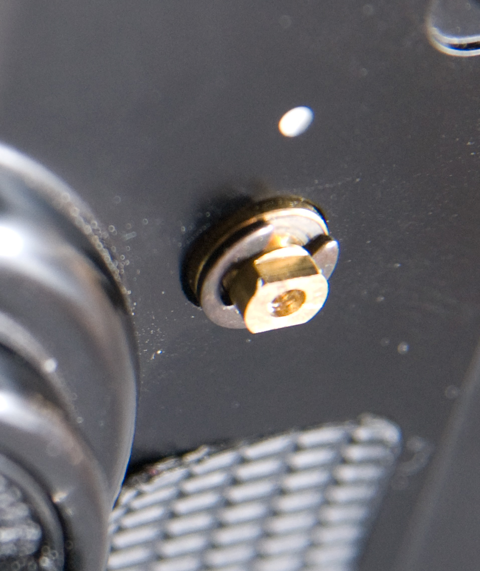

The disc seen in the photo does unscrew, there is a metal mechanism with a tiny bolt underneath, which the plastic lever connects to. My first reaction when it failed was why Bronica would use such a flimsy plastic part on a commonly used function.

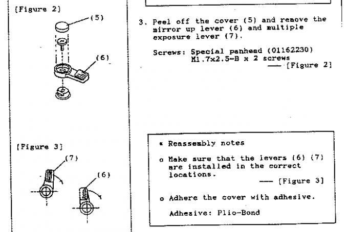

Bits from an ETRSi repair manual . . .
So it's a little bit with a double "D" hole, I suppose one could do some creative work on an odd chunk of alumin(i)um with a file. It wasn't real obvious in the photo, but the round disk is actually a screw with a special head shape. Probably an easy do-it-yourself job if you can find a part.

Seeing the drawing I was thinking of a selftimer lever.

With the detail in the new pics it wuld be really easy to fabricate from that there aluminium stuff.
Why do you folk have to add them thar extry letters to all them words?
Self timer lever sounds like a good idear IF the hole was smaller to begin with, if larger it's difficult to fab up a part of a hole. Fill it with JB Weld & drill/file it out I guess.
