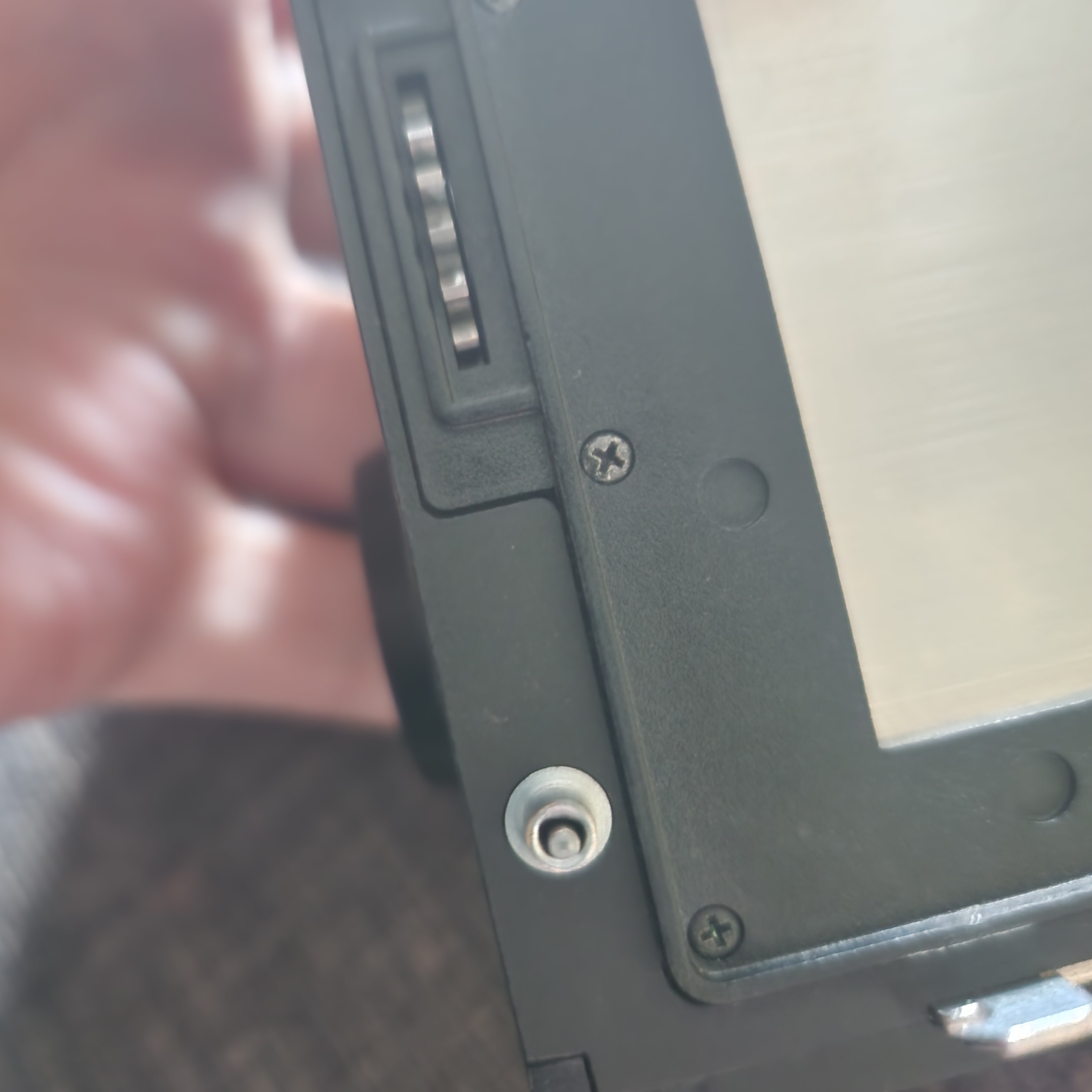

This is the film.back, should this needle move about?
That is likely the film-advanced interlock pin, and it protrudes from within its protective metal sleeve to activate the mechanism within the body whenever the film has been advanced to the new frame.
There is a similar pin elsewhere on the Ai back for the darkslide interlock, which prevents shutter release when the darkslide is left covering the film.
