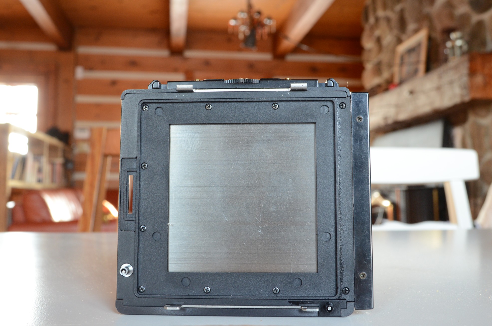

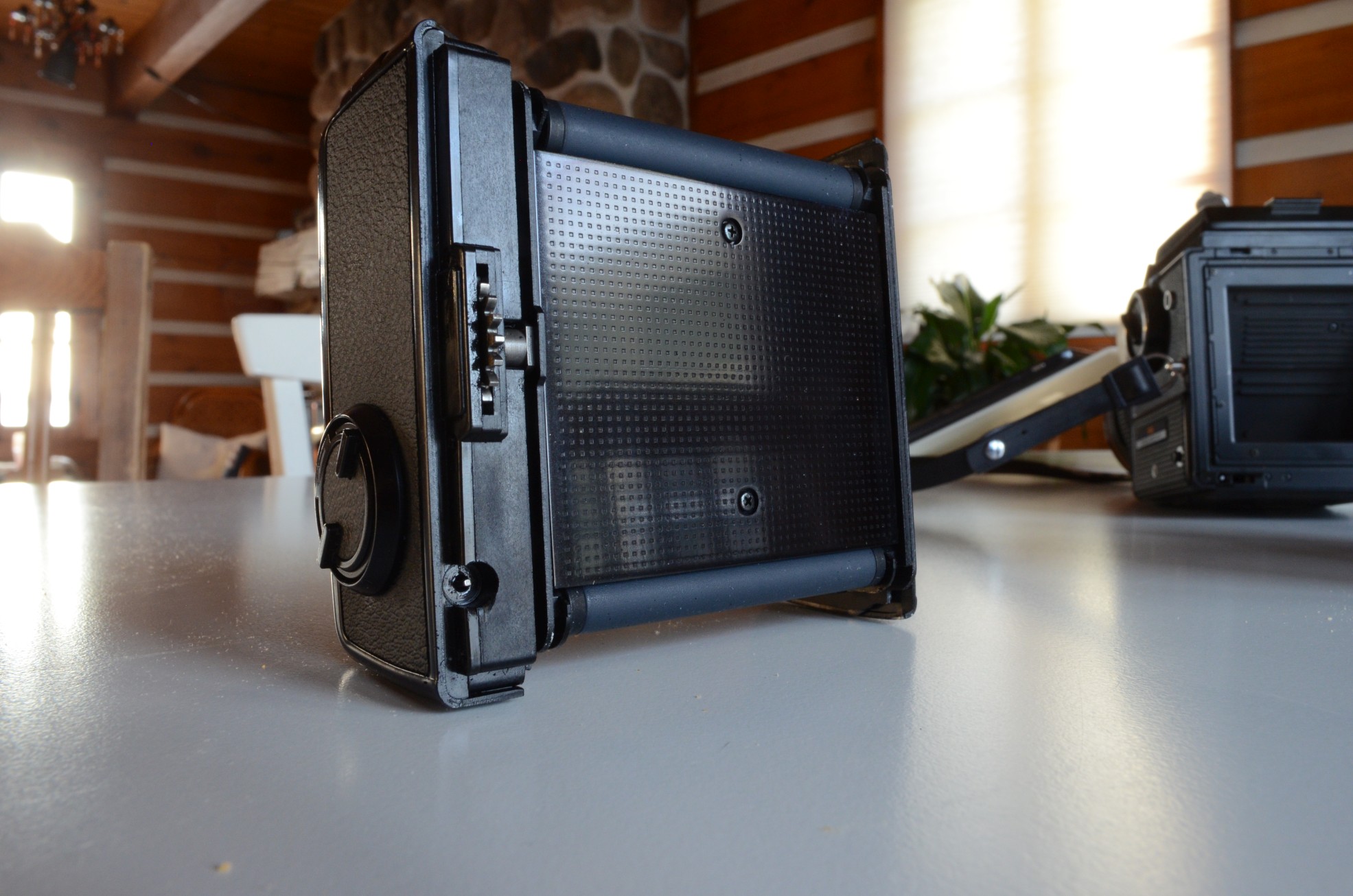

I faced to the same yesterday. I decided to add pictures so it's easier to understand for those finding this thread. How explained above, the back uses two needle-like parts to communicate with the body, one should mark the dark side injected, when yes, the pin is out. This is on the left side of the next image. The other is the film position marker, it's always out on the back side which pushes the body side's pin telling the next frame is ready. When fired, the camera pushes the pin back which tells the back to go to the next frame. This is on the right side in the picture showing the body:
See the next picture with the back, the dark lock is at the bottom right corner. Notice: it must go back on its own when the slide is removed.
Here the disassembled back showing the pin outside of its tube. It may be bent a little but otherwise it should just be easy to push with a screwdriver.
What I did was to apply lubrification on both pins so they are free to move.
