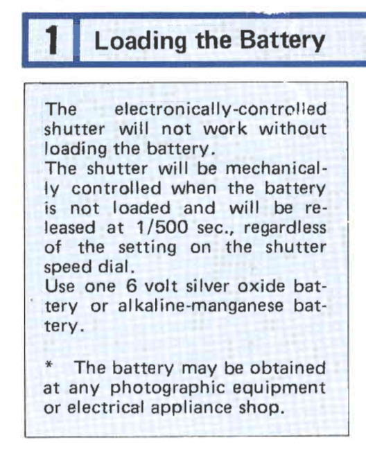

Nope; the SQA(i) doesn't fire without batteries fitted. So that's not the problem.
Actually, I am pretty sure there is a difference (I checked the manuals, but not a physical SQ-A). The SQ-Ai will not fire at all with no batteries; but the SQ-A and earlier SQ will fire at the mechanical 1/500 speed with no battery.
It is still quite possible that the lens or contact is a problem, and another lens or body should be tried if possible, which often helps narrow problems down.
Attached screenshot is from the SQ-A manual:

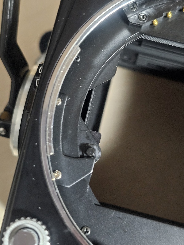

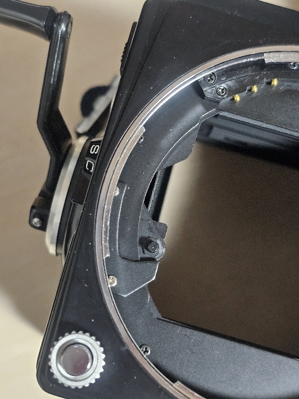

In fact, the problem with the camera wasn't that the shutter speed was 1/500, it was that it wouldn't shut off!" !
Look at these two pictures.
The first one shows where the shutter is thought to have worked correctly, the second one shows where the shutter did not work correctly.
In the second photo, you can see that the part of the lens that engages with the pin to activate it has not moved all the way to the end.
This means that the lens pin also stops in the middle, i.e. the shutter does not release.
However, I still don't know how to solve this. If you all don't mind helping me with this, please help me.

The photo you posted seems indicative of a mechanical issue within the body, but it might be caused by the interaction with film back or some other internal adjustment/need for lubrication.
