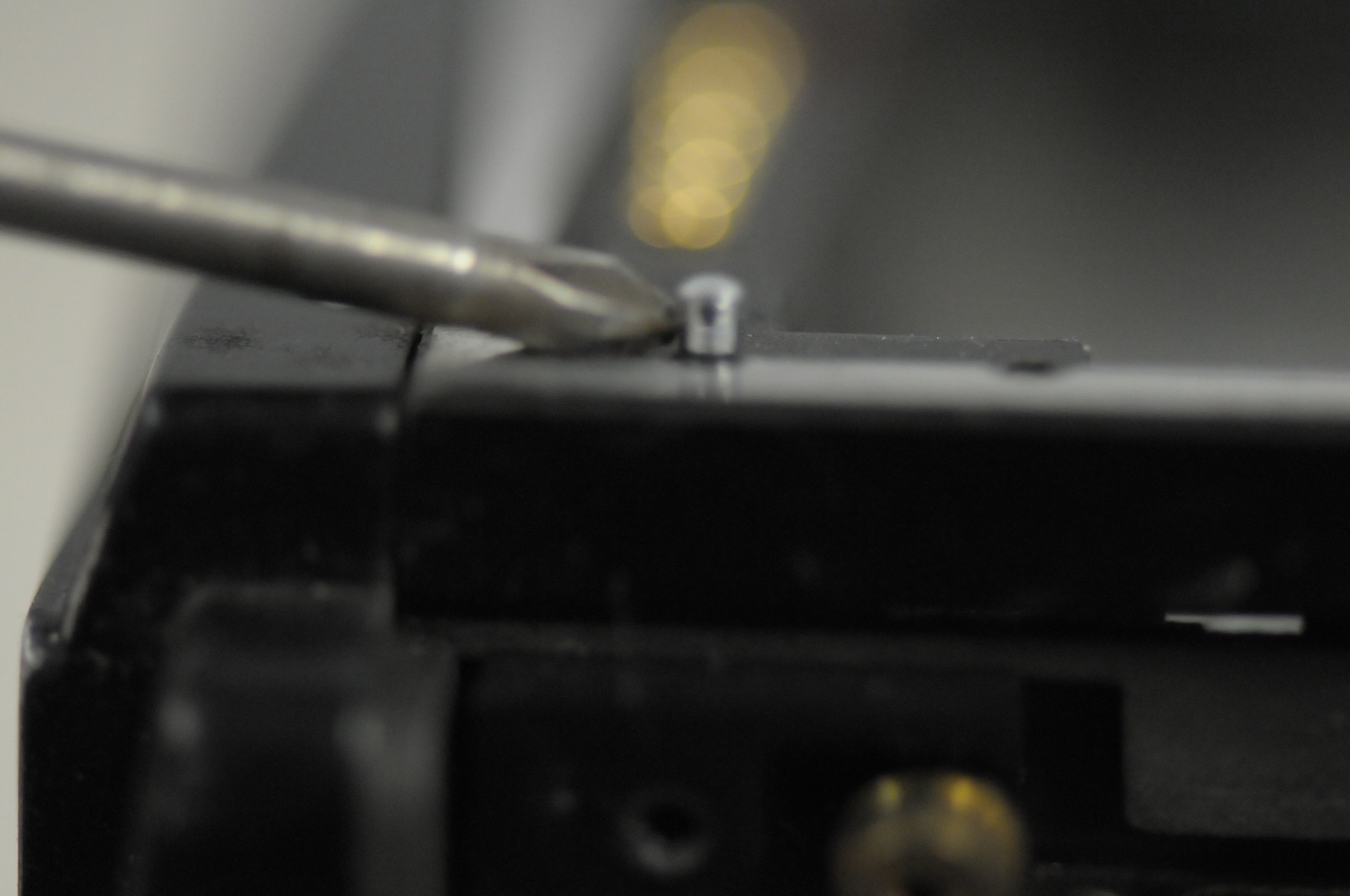

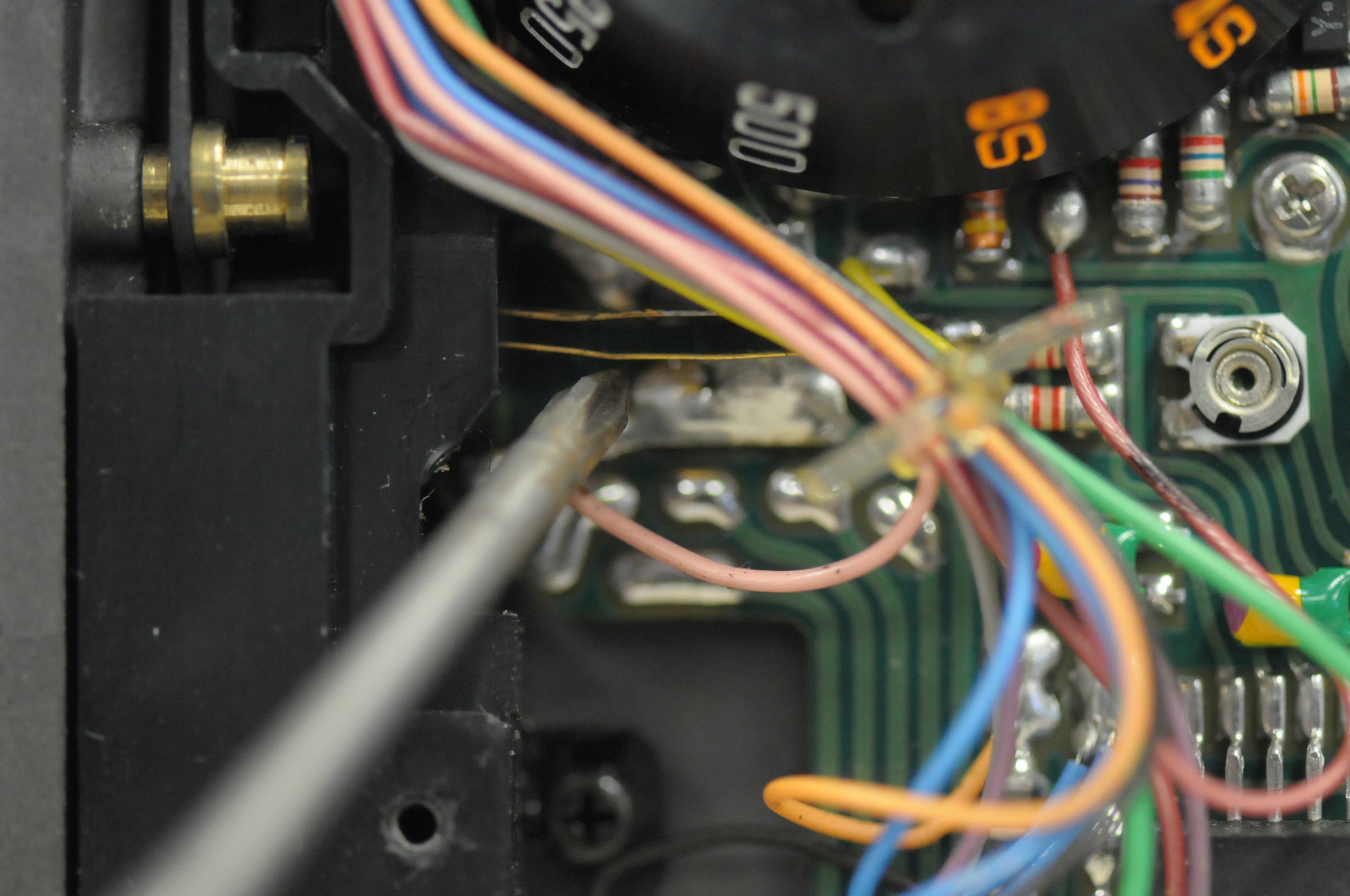

According to him, it's either going to be the lens or the body-- you tested the lens on another body. He said to check the "finder top pin" (first image), and the contact (second image) and that if it's sticking, or open, the camera will only fire at 1/500.
View attachment 258533 View attachment 258534
Thanks for the images! The finder pin appears to be operating properly. It actuates like it should. So my guess is the contact in the second image.

Note that the if the contacts for the finder pin are stuck in the engaged position, then at least two of the 8 contacts across the top of the focusing screen are trying to complete a circuit with the speed dial (I haven't looked at the wiring diagram recently). Effectively, the speed dial has been removed from the camera's operational circuit without the AE finder.
While it's not exactly the same, there is an ETR Si repair manual online at butkus.org. There appear to be heavy similarities between the two units, enough that the pictures provided by Mr. Koh match fairly closely with the images in the manual under the Troubleshooting guide, page P-7.
