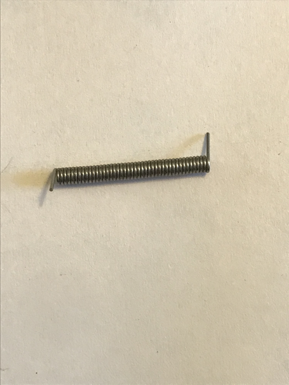

Hello everyone. Hoping I can find some help. I recently got a Bronica SQ-A. I'm completely obsessed with it.
But today, I found that the magnifier in the waist level viewfinder wasn't popping up as usual when I pressed the lever. After looking closer, I could see that the "axle" the magnifier hinges on came out on one side and the spring got dislodged.
I've been working on this for hours -- and looked at every image of an SQ viewfinder I could find-- to see how that spring is supposed to be oriented on the "axle," but I just can't figure it out. I'm able to slide it back on the axle and get the axle through the right holes, but the swinging action of the magnifier still isnt' working right.
Here's a picture of the spring that slides over the metal "axle" - if anyone with a bronica sq could take a look at theirs and tell me how those little feet at the end of the spring are supposed to be positioned for this thing to work correctly, I would be greatly appreciative.

It should be positioned so that the spring is compressed when the magnifier is closed out of the view path.
Pictures of the viewfinder and magnifier will help if others do not respond.

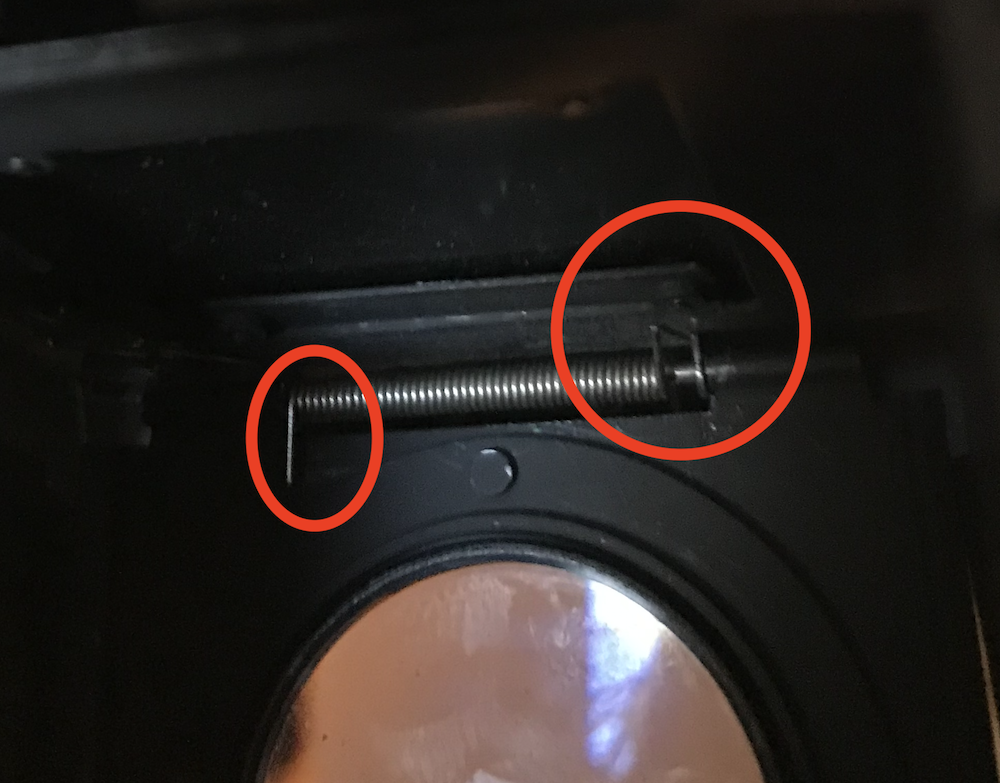

Yeah, but I'm having trouble figuring out how to make the tension work. I can get it about halfway there - but something still isn't right.
Here's another pic (from the underside) with the spring back on. I circles the two "feet" of the spring. One of them isn't in the right place but I can't figure it out. Maybe I need to twist it another rotation before fixing it on to the post
Roy Keane
Roy Keane
Mar 22, 2021
115
MA
crap...thats not it. I think I have to tighten it one more revolution, but I can't figure out how

Start the spring on the hinge pin as shown in post 4 leaving the end out so that the spring arm will clear the finder and magnifier, grip the free arm with needle nose pliers, rotate the spring the needed amount then push the hinge pin through and seat it before releasing the spring. Likely easier typed than done.

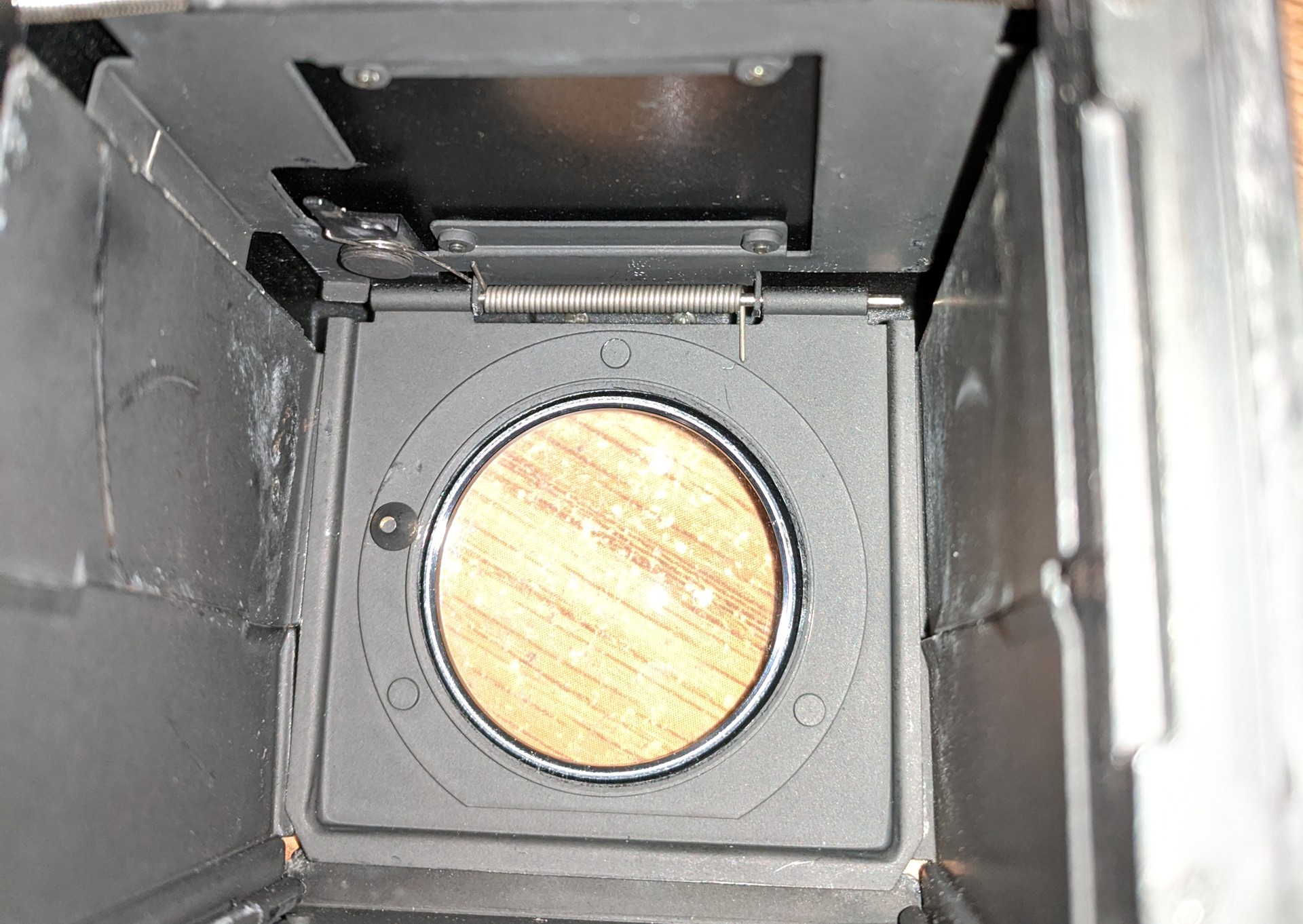

See if this helps:
I think your spring needs to be flipped.
Yes, I think so also. If you look at the tails of the spring the one on the left that touches the front of the WLF is flush to the front, and the one on the right is flush to the flip up part. Mine is the same. I think this way you will get more tension.
it doesn't have to be flipped. The spring is the same if you flip it.
The trick (I think) is that you have to twist it (to give it the tension it needs) as you set it behind the magnifier window. And you have to somehow do this while you're holding the spring in place with a tweezer/pliers.
Basically, you need he-man strength, a locksmith's dexterity, and fingers the size of an infant.
