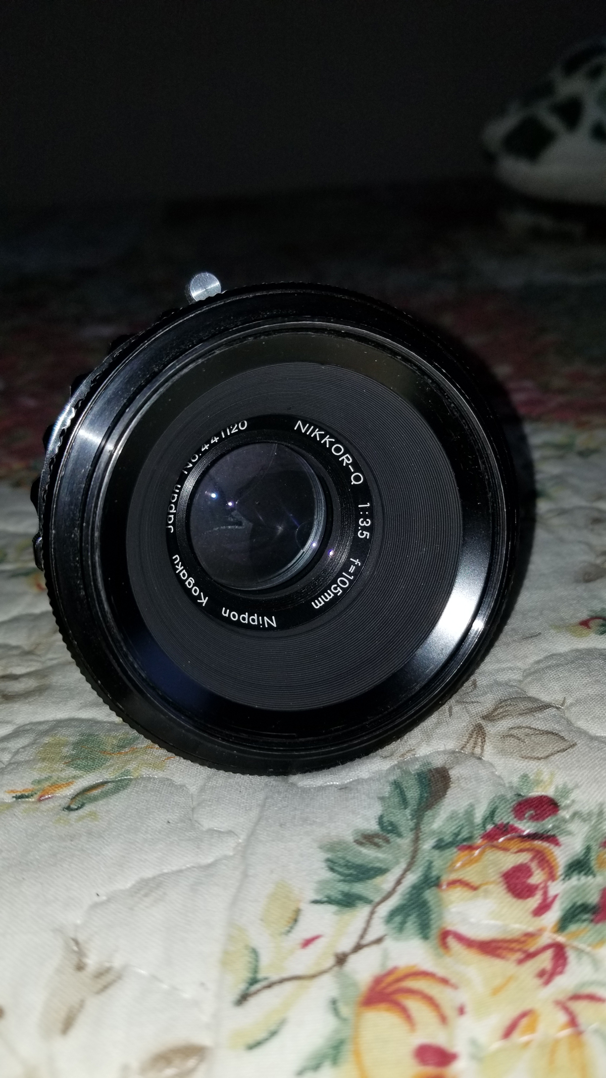

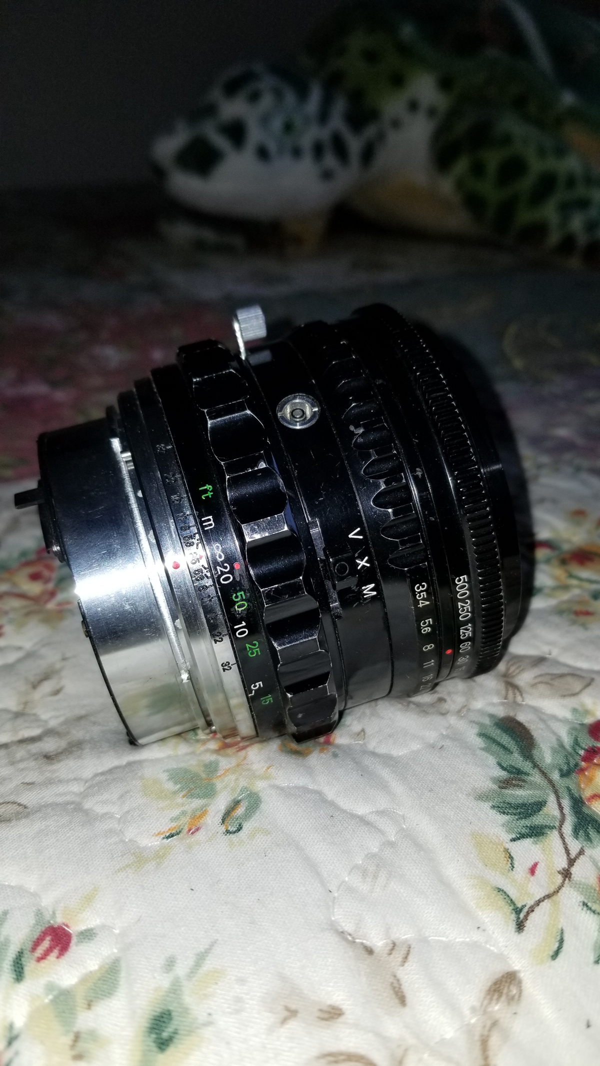

I have had my Bronica S2A cameras almost 20 years now and have never had any problem with the flash sync not working. There is the a 105mm leaf shutter lens which will sync to 1/500 of a sec. They are a little rare, it took me several years to find one at a decent price on ebay. You have to cock the leaf shutter in between shots.
