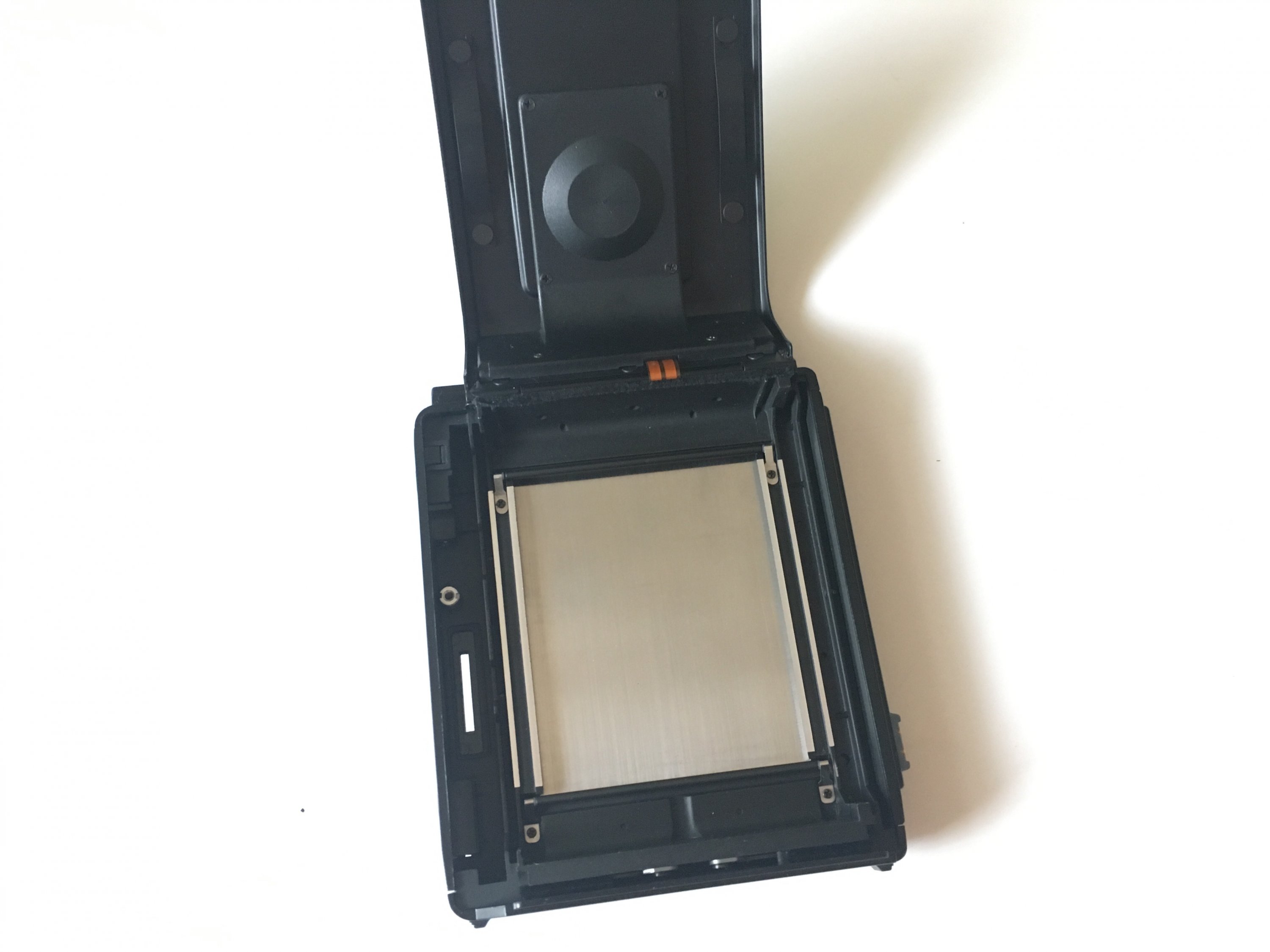

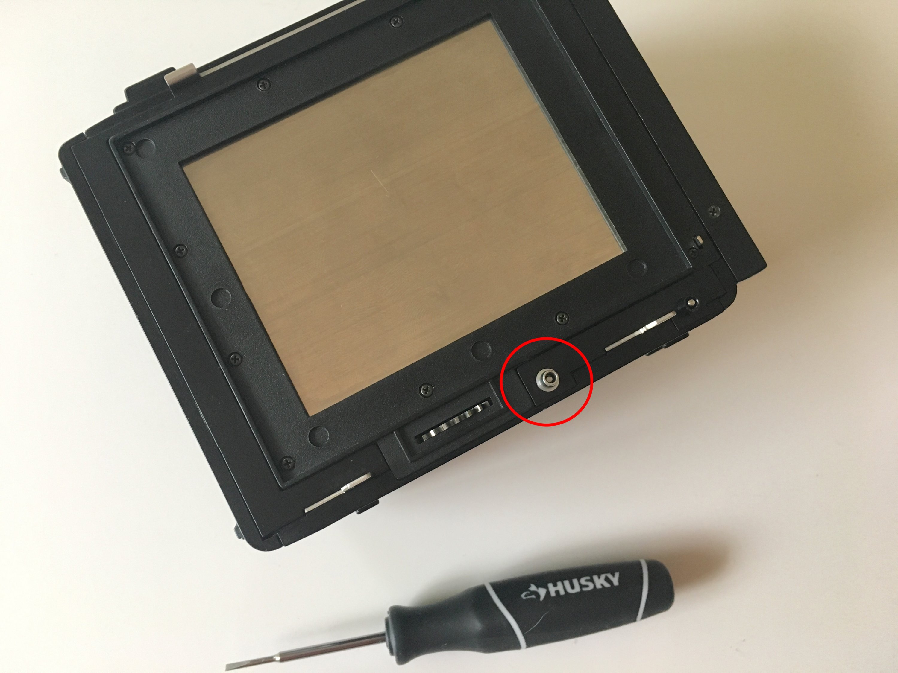

Thank you so much for being thorough and offering suggestions/help, I REALLY appreciate it. I've done more troubleshooting and I'm still not sure where I'm at with figuring out this issue. I've attached three images, the first showing one of the pins on the film back which i have circled in the image.
After loading the backing paper and then attaching the film into the film back, I pressed the pin down with a little screw driver and I was able to advance the counter but it wasn't stopping at individual numbers, it was just letting me keep advance it but I was able to see multiple numbers which was a first. I'm not sure what this tells us though. The other two images show the tabs you were referring to and the film back door, everything looks good to me and the tabs definitely move when the door is closed, so it's hitting it properly. Again, thank you so much for your help.

What you did resulted in normal functioning. Holding that pin down will let you continuously advance the film and counter.
If you don't hold it down, it should only advance to the next frame, incrementing the counter, and then stop - though the winding knob itself does not lock (it can keep spinning), the rest of the mechanism should stop at the next frame.
There is also a chance that if you keep poking at it, it may start to work. If so, I don't think I'd trust it for anything important, but at least you could test everything else.
I tried a few more things, but could not replicate your issue. Look at picture 1. Notice the pin at the right lower corner. I believe that is what allows you to remove the back from the camera. If the dark-slide is removed, the pin falls back, and you should not be able to remove the back from the camera (saving your film). On the right side is a small rectangular metal tab. Press that in and you can remove the slide (and the pin I mentioned retracts). You'll notice a small tang on the removed dark-slide that basically pushes this pin into place, letting the body "know" it's safe to disconnect.
To replace the slide, you have to press the tab - you are acting like the surface of the camera body.
With the slide removed you can see if the paper moves when you advance. This is important, as you can always spin the winding knob on the back. When film gets to the next frame it should stop advancing, but the knob can still spin (this is normal).
I pressed the pin you circled - both with the back open and closed (and also just on the insert). It seems to release the advance-lock when you push it in. A rod probably engages it momentarily when you fire the shutter. Holding it in will allow the film to advance continuously.
On a working back:
- If you hold that pin in, you can continually advance the film and the counter will keep moving.
- If you release the pin, the advance should stop, and the counter stop moving, once you get to the next frame. However, you can still spin the winding knob, but everything else should be stopped.
- One simple press on that pin (then remove the screw driver) and it should advance the film to the next frame as well as increment the counter to the next number, and stop - though you can still spin the winding knob.
If the rod in the body is continuously pushing in, the back would never stop advancing, but the counter should also keep rolling.
There is something I can't account for. Look only at the insert. Above the gear is a rectangular piece of metal with holes on either side. I don't know if this is of significance, but the ridge on the back itself seems to accommodate this - though gently poking I cannot get anything to move.
Thanks so much for your help, really appreciate it! So I just tested this out and I could see the paper moving but the actually number counter stayed at "S."Does this tell us anything? Maybe the counter window is just messed up? I've talked to the seller and he refunded me the amount for a new back which I have purchased off ebay, should be here by this Friday - so we shall see.

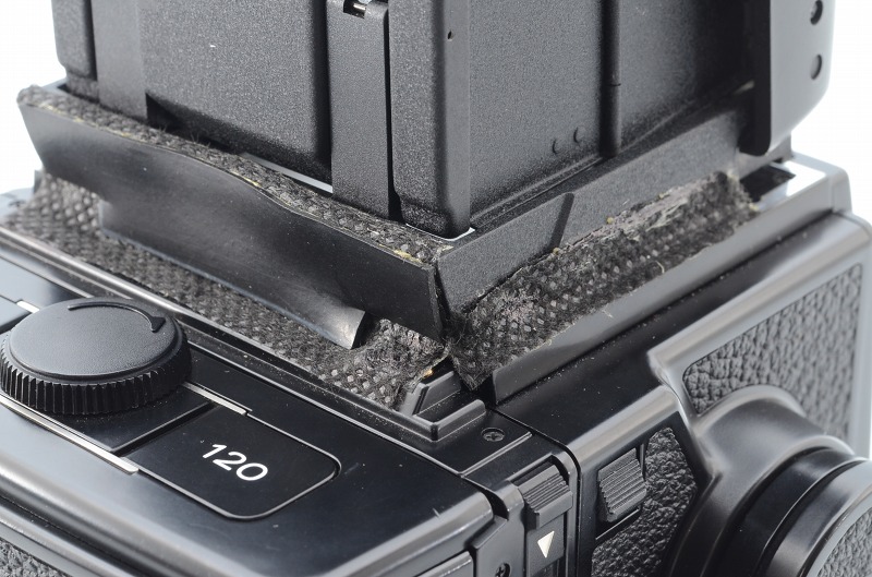

New film back is supposed to be here in a few hours - excited to test! I had another question I thought I would ask, I saw on ebay a few days ago a Bronica GS-1 with a Rollei 6006 waist level finder which I thought was odd. I've included pictures of it below. Trying to find a Bronica WF for the GS-1 is super hard and was just curious if its possible to use other branded waist levels?
I saw that on ebay too. I don't know much about the cameras, though, so I can't really answer your question. I merely own and use one, lol.
Looking at those photos of the Rollei finder, you can see the person taped the gaps - presumably to keep light from making it hard to see the ground glass. I would suspect anything that would "fit" might work. You could probably fake it with some tape and cardboard (and a magnifying glass) until you find a proper WLF for it.
