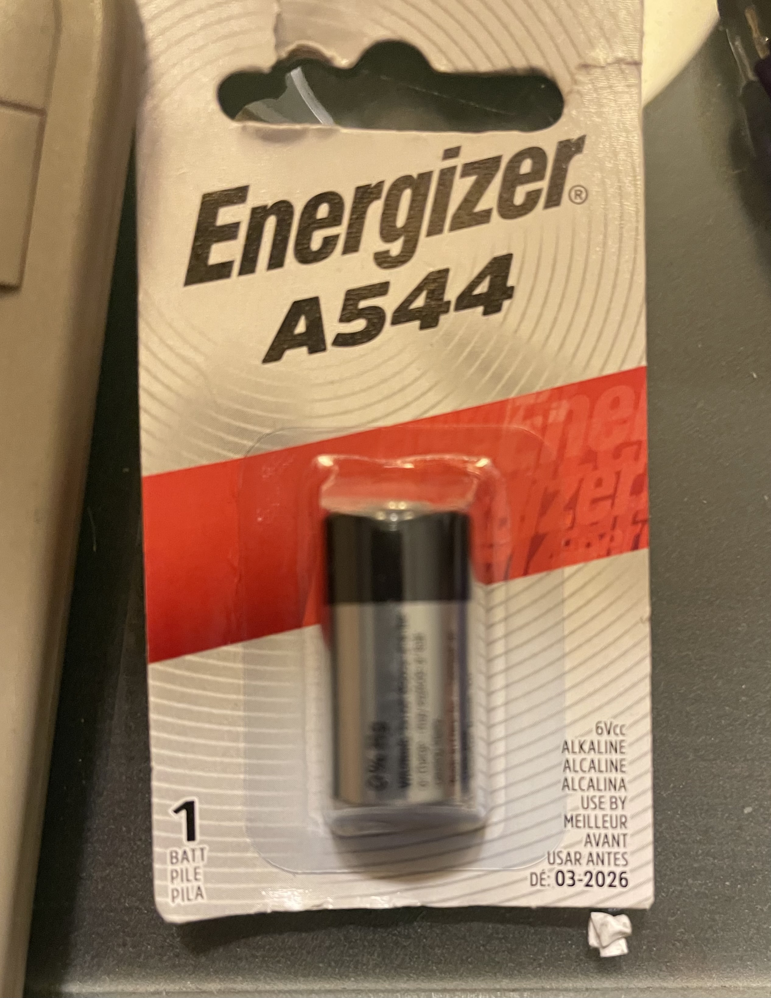

Assuming this Energizer A544 is good to go, and a substitute would be the Duracell A28, correct?
