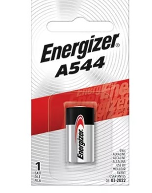

If you happen to be using an old PX28A battery, or an inexpensive one, I'd try a new, name-brand battery. That may not solve the problem, but it would make the battery less likely to be the culprit.
Hi! Ive bought this one. Should i try other brand? Or other type of battery? The thing is that i already shoot an entire roll without problem. And i bought 2, so i tried the new one and the problem was still there.

My understanding is that an A544 is the same as a PX28A. But sometimes batteries that are NEW have been sitting on the shelf for a long time -- and not generating full voltage. You need to test the voltage of the battery you used in the camera.
It measures 6,25 V. Is it okay?

That's PERFECT.
Yeah, i knew it. Im an electromechanical engineer and im guessing the electric signal that times the mirror is failing. I dont have the tools to open it but i will search for someone who does.
