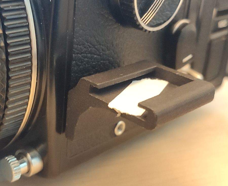

Things changed. Now I can 3D print an L-shaped cold shoe mount and put a light meter on it when I want to travel light without grip and AE viewfinder.

@nicholasnicholas @choiliefan I think you're both misunderstanding a little. The point of the original thread was that the original ETR has a mysterious little cleat on the left side of the camera. Suzuka Lasagna appears to have 3D-printed a cold shoe that slides over that cleat. No double sided tape involved, but also one would need the 3D-print file specifically for the cleat, or print a generic coldshoe and file a cleat-shaped notch in it.
The cleat disappeared from the later models, ETRS, etc. You can see a picture of it here, the chrome rectangle marked Zenza Bronica on the left side below the shutter speed knob (link to flickr image):
For posterity here's a detail image just to show the cleat:
