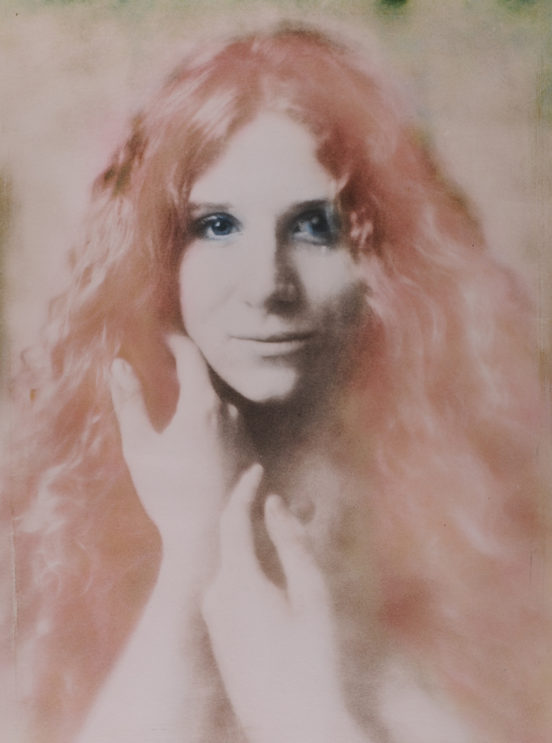

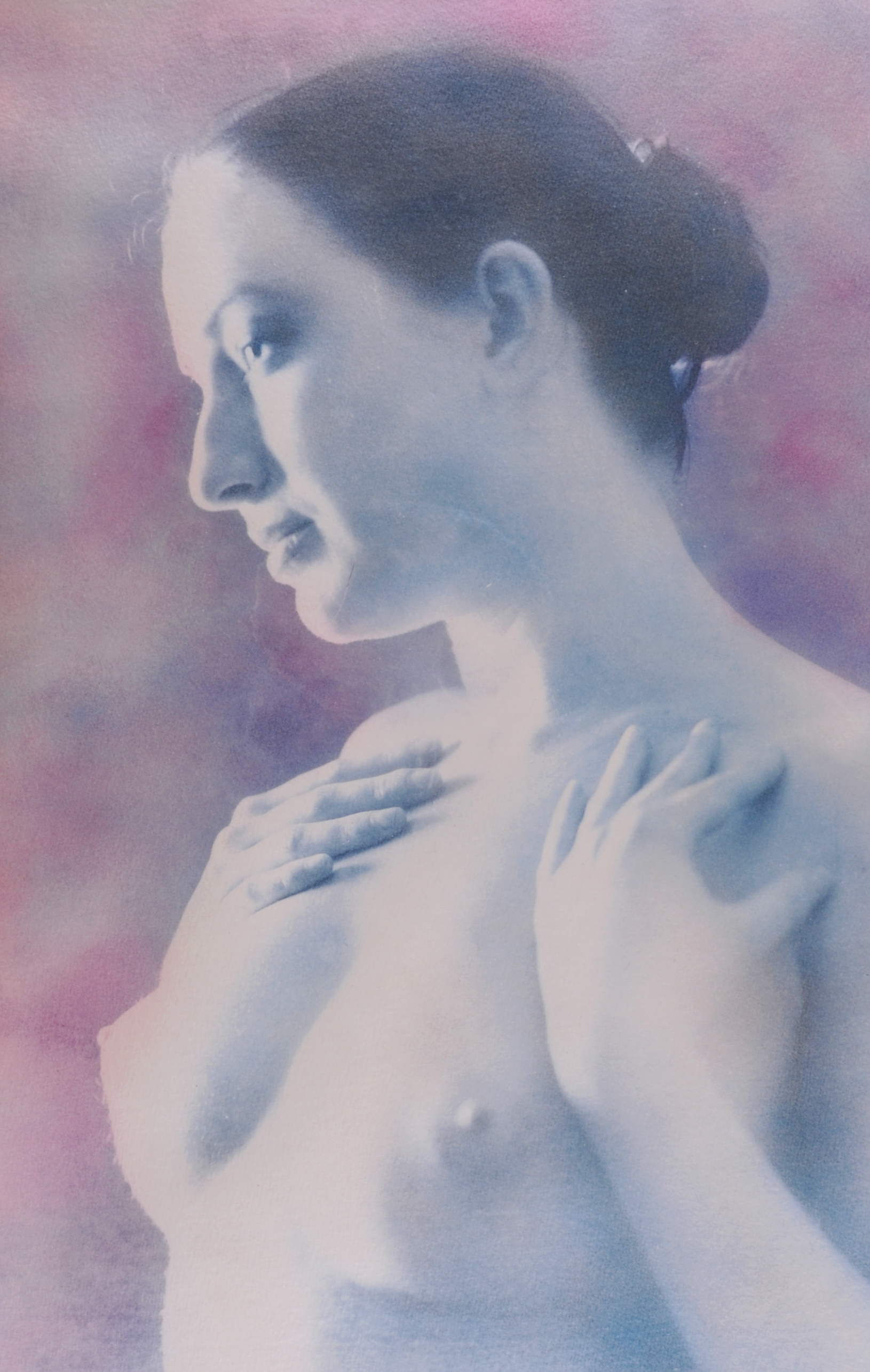

I don't believe he published it so you probably need to buy his book (wonderful images in it) on Bromoil Printing with Liquid Emulsion. He has several books he has put together and they are available on the internet. He doesn't spend a lot of time describing his process in the book using sponges instead of brushes, but there are a few U-tube videos of his process and images out there as well. I could never get brushes to work very well, but I don't know if the traditional brush application method will work very well with liquid emulsion because the emulsion is fairly thick. Emil Schildt is active on this forum and has given me some valuable advice.
He brush coats his paper with the emulsion, but I've also been using Denise Ross's coating technique with a glass rod very successfully.
Here are a couple of color bromoils I have done using Emil's technique (hope they download properly)
Dan
Could you write some short summary for newbie of the technique? I'm totally interested trying this with Foma emulsion.

hi dan
wow, those are beautiful!
I have one of his books, I will have to look again through his posts and for his notes ...
thanks for posting this info!
