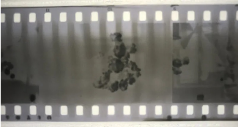

Thankfully I never had either problem but I thought these examples may help.(taken from the web)
Surge marks and I think it also looks very similar to stress marks.

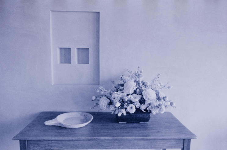

Bromide drag.
@foc there's a lot going on with those examples. The first one looks like stress marks mostly and not really surge marks. The second looks like insufficient fixing for the most part. Possibly a photographer experimenting with stand development and attempting "stand fixing" as a logical extension (which doesn't work).
