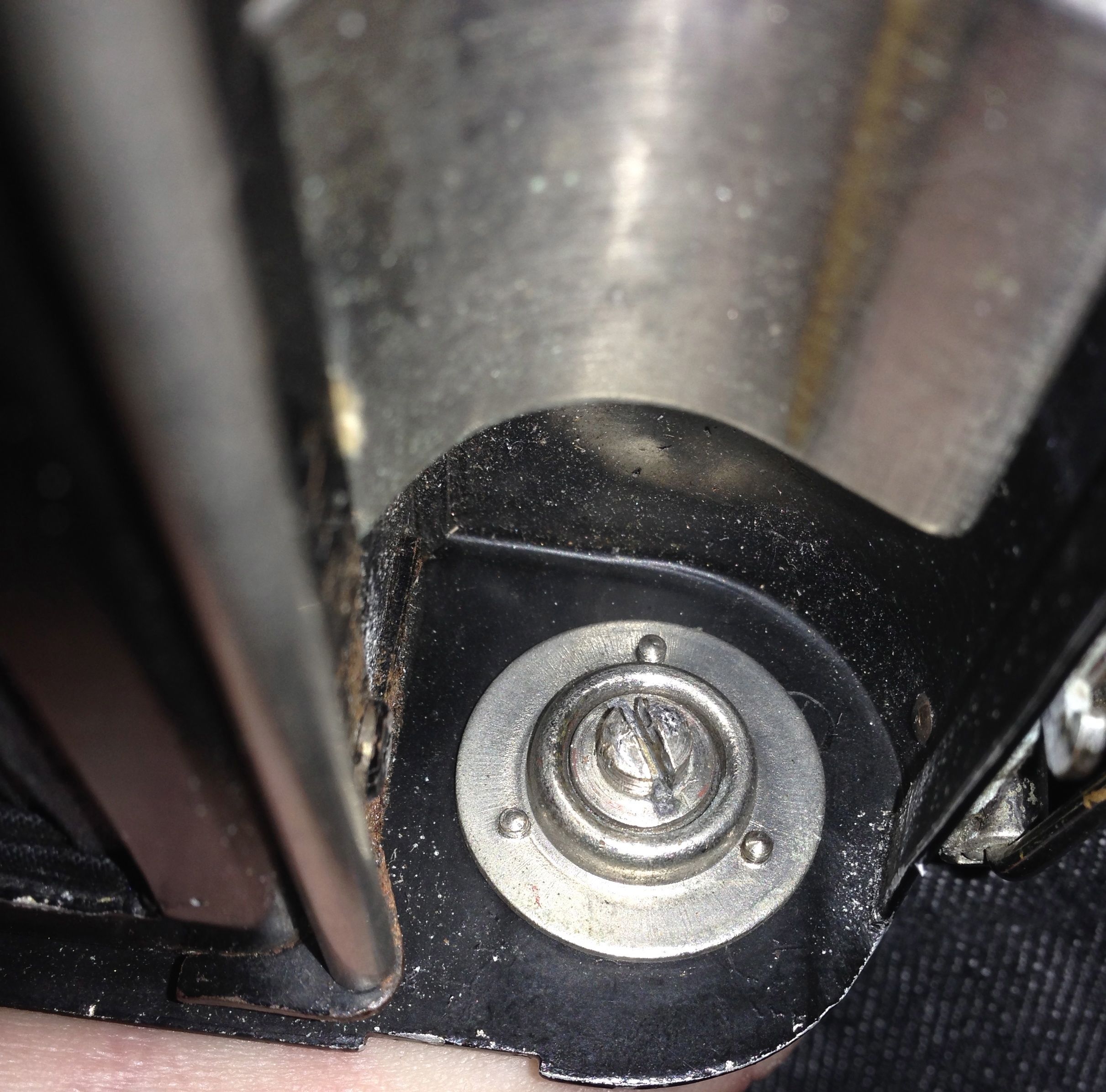

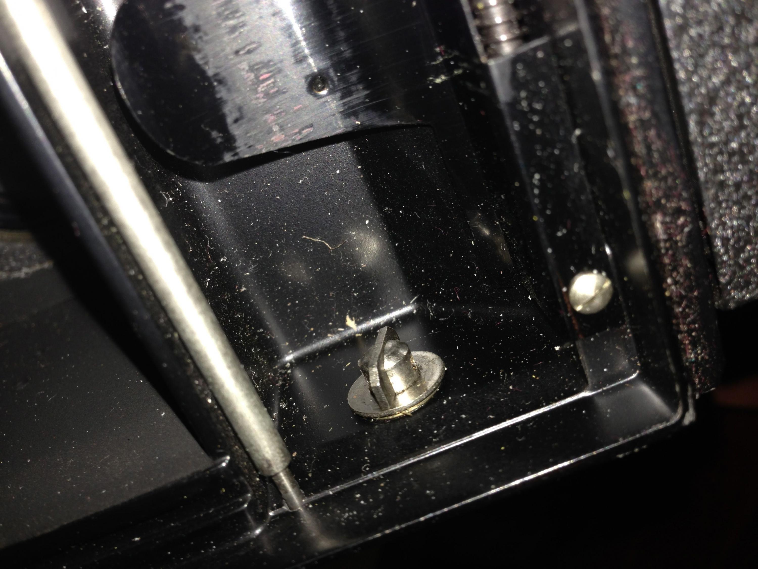

I have a Ihagee Ultrix Folding Camera that is missing a bit of metal that holds and spins the take up spool.
Where the piece is missing.
The piece pictured in another camera.
Any help on how to replace or where to buy a new piece would be greatly appreciated.
- Thanks

Your camera is 170 dollars at ebay , very expensive camera , may be you can order from 3d print services if you can figure out its 3d shape.
If your part is rotating , may be you can figure out a part to enhance its lenght and touch the spool. Or you can attach something to spool , a wooden plywood piece shaped by small knife and polished with 1000 grade paper could work.
- Thanks
That's not actually "broken" - the rectangular piece with angled corners has simply loosened and fallen out, for whatever reason. It would be a simple job (for someone who can use a file and saw) to make a new piece from sheet steel or brass of the appropriate thickness and fasten it with one of the stronger grades of Loctite. If you're going to DIY, disassemble the spindle so you don't Loctite everything.

Take the thing to the local hobby shop or craft store & buy a piece of appropriately sized brass.
It's hard to guess thickness from a picture but if they don't have a single piece thick enough use thin pieces and layer it up with epoxy.
I don't believe Loctite would work well to hold the beast together. Epoxy would be my choice.
The way this fits together I'd mix up a little bit and basically just wipe it on the newly made key. If you can see runs when you put it on IT'S TOO MUCH! You want barely enough to notice.
If you can give me accurate dimensions (top & bottom width, height and thickness) of the key I can make one up for you.

You might be lucky and find that an aluminium rule is the right thickness for that slot, in which case cutting it to size and shape with a small hacksaw or Dremel will get you the part you want, then epoxy into place.
You must only have experience with the stuff you get at homeripoff...:laugh:
Personally, I'd put a taper pin through and rivet the small end, but most folks have neither the skills nor tools to do that.

If you can get a longish piece of stock the same size in stainless or brass you could bend it hard and straighten it or forge a dent with some creative hammering so that it was distorted in one spot. That spot would be wide enough or bent enough to require minor force to hold it in, then cut to length. Plus epoxy or glue that could assist in holding it.
