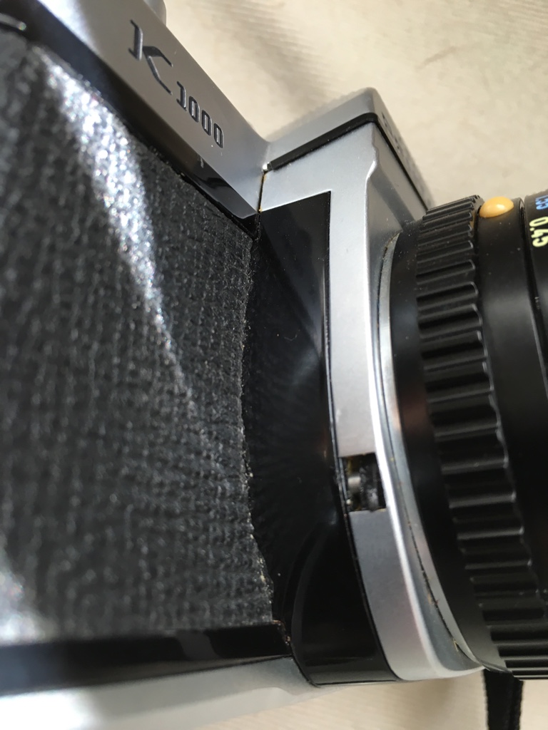

Recently bought a near-mint condition Pentax K1000 body from Adorama's ebay store, and was thrilled to see how great the condition on the camera was, until after I put a lens on and discovered I couldn't get it back off because the lens release button was completely broken off down to the metal.
This wasn't disclosed in the ad, which is more than a little irritating, and you couldn't really see it in the photos unless you looked really hard. Their only solution offered to me is to ship the camera back to them for a refund, but it's in perfect shape otherwise so I wan't to keep it. For now I'll just use my one lens. At least it's a decent one (mint 50mm 1.7). I *can* depress the release spring, if I use a swiss army knife and apply just the right kind of pressure and kind of jiggle it, but I can't imagine trying to do this 'in the field'.
I've done a search online in vain, and can't find anyone who sells just the button. Any tips on where I should go to find a replacement? I looked at ebay for 'parts-only' K1000 bodies, but they cost anywhere from $25-$40, which isn't worth it. I don't really want to ship it off to a repair place because it will cost a lot more than the button is worth. Also, it seems like replacing a lens release button is a relatively easy fix. Is there any reason why I 'shouldn't try this at home' if I am able to find a button? Thanks!

Army knive is something you should keep away from camera and lenses as far as possible...
In case you have some sheltered DIY inclination:
Sticking to old photographic gear, you certainly need a good set of basic tools, these include high-quality small Philips-head screw-drivers.
I assume it should be easy to take off that front apron with one of these. Then you would have access to that pin. You then could glue a make-shift knob onto it.
We have a camera repair subforum and I'm sure a lot of makeshift ideas would come up.

There is more to replacing that release button than meets the eye. Take a close look at http://www.pentax-manuals.com/markroberts/k1000_man.pdf before you try to fix it yourself.
Thanks for the manual shutterfinger. I already had that exact manual and looked hard through the whole thing trying to find anything about the lens release button, but couldn't find anything. Can you tell me what page it's on? I'd love to see if it's feasible on my end (I already have the tools I need).
