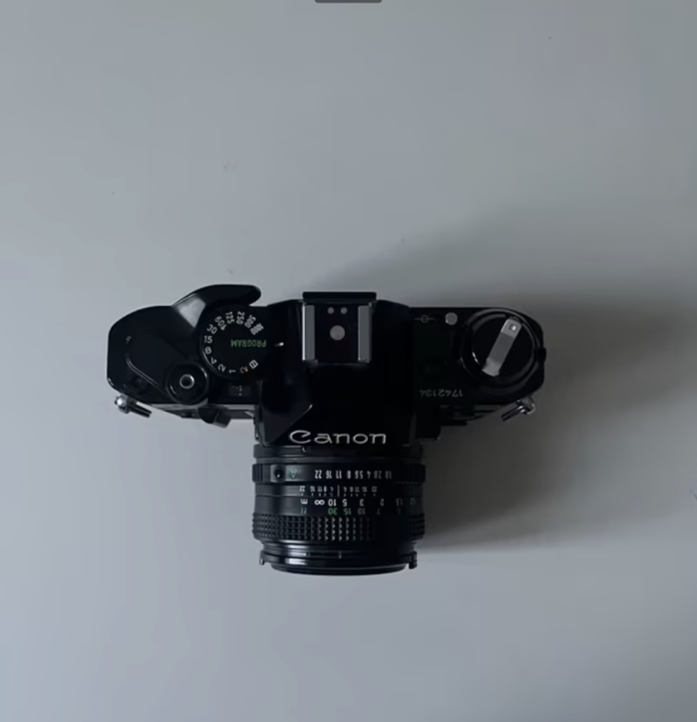

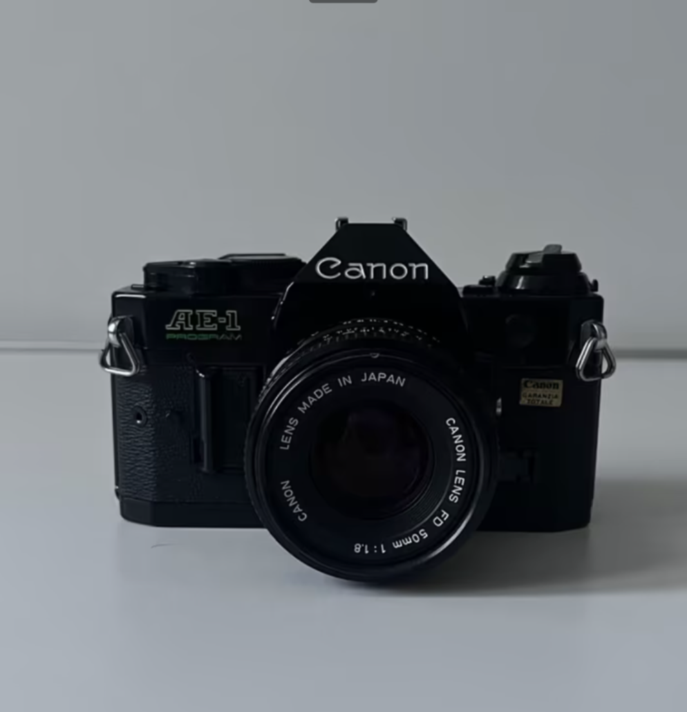

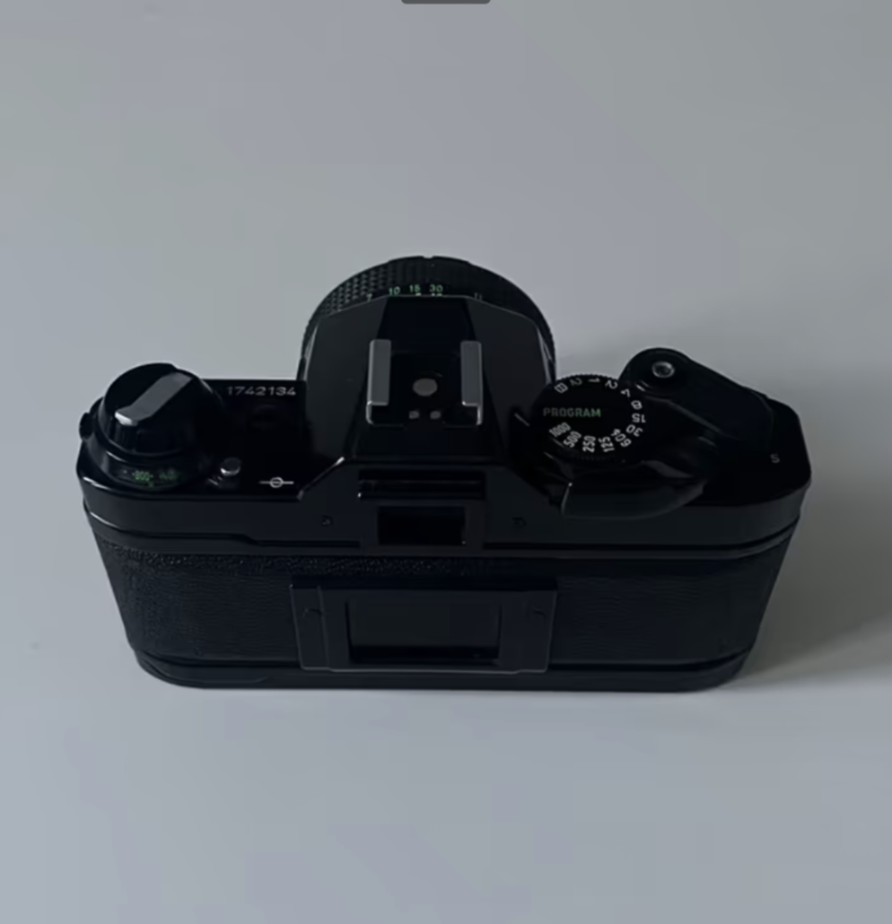

I could almost blindly buy a Canon AE-1 Program for around 40$ shipped without the lens (see pics) that seems to be in good aesthetic condition but does not work. The advance lever does not travel as if the shutter was already loaded. Do you think it makes sense to buy it, maybe try to fix it and sell it, or is better to leave it be?
I have some (limited) experience with servicing this model and I know of a very common problem with shutter magnets that has a pretty easy fix.
Comments other than vote much appreciated.

Was it tried with a battery? It needs a battery to fire the shutter.
Chan Tran
May 10, 2006
6,808
Sachse, TX
The camera may be OK because it needs the battery to release the shutter. If the shutter is already cocked you can't advance the film any more until the shutter is released. It's black which is rare. I paid $17 for a chrome one with the 50mm f/1.4 at an estate sales.
