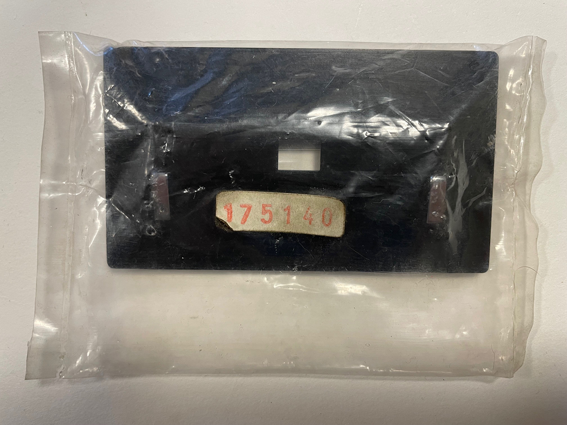

Your dad, buying expensive equipment would have liked Leitz enlargers. Here a picture of my Leitz Valoy II which was in production from the late fifties to the late sixties.
This is a light and small enlarger. First they were black, then blue-ish grey, then finally light grey like the one in the picture. Not sure of the year when it turned light grey.
Mine is a bit misleading because the nameplate is from an earlier black version, normally the light grey versions come with the red dot nameplate. My Valoy II does have the baseboard, the one in the picture is attached to a Leitz table clamp which can turn this enlarger into a reproduction device. Not bad for a spy.
Both the Leitz Focomat Ic and Valoy II are 35mm enlargers. They come with replaceble negative carriers down to Minox size, which is 8x11mm. Also attached.
The Ic is the heavier and larger enlarger between the two.

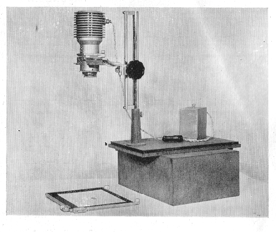

This is from my Universum instructions, the only problem is the enlarger actually has a different column, angled. I did make 20"x16" prints with it a couple of times.
It's also heavier than I'd thought 6.1kg.
Think unwieldy because it doesn't balance until you add weight to the baseboard, in this case the transformer is heavy enough to counter-balance.
