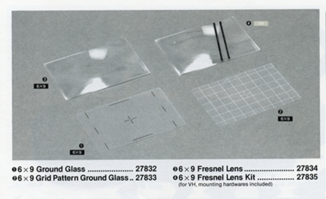

The Horseman VH-R came with the fresnel lens and I believe, it may have been an option for your camera or someone removed it. If it was removed from your camera, it should still focus OK because the fresnel is mounted on the side of the ground glass AWAY from the lens.
It was available with or without the mounting hardware, depending on if you camera came with one originally.

Dear all, thank you for replying.
Honesty i don't like so much the fresnel lens: viewing is brighter for sure but harder for focusing due its 'texture'. On my 4x5 Sinan F I removed it, using only its clear and already bright ground glass.
I saw some prices of Maxwell screens and I do think they, even respecting the quality, are too expensive for a Horseman and that there's not an reasonable alternative to the original one.
If I find I would chanche the current #27832 GG whit the grid pattern one #27833.
