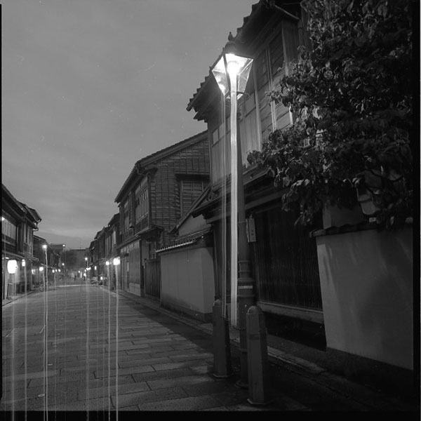

Some years ago I put a bosscreen on my technikardan. It made a big difference to the viewfinder brightness but I've always found it difficult to focus exactly.
I just put back the original Linhof ground glass and using a 45 reflex viewer in dim light just after sunset, I was able to focus really accurately even though it is far less bright than the bosscreen.
The crop is from a notice board to the left of the arched church door and is at 100% of scan resolutoin which was done at 3200dpi unsharpened. On the neg with a 6x loupe, I can read most of what is on that notice board so I'm really pleased I put the old GG back. It just seems to snap into focus unlike the bosscreen.
