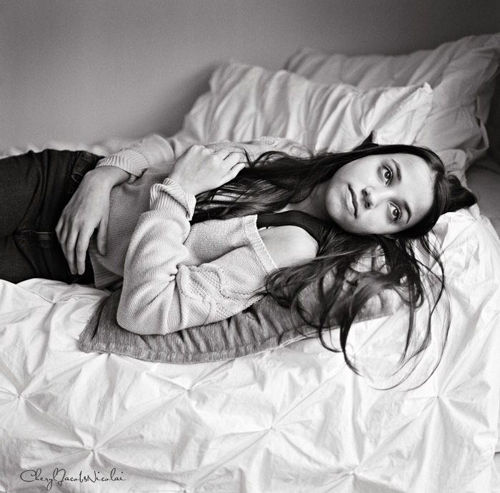

Whether you use strobes or available light, the magic is 99% in your lighting and exposure rather than your printing technique. Expose generously, really look at the lighting falling in the subject's eyes, practice reading the light without the camera in your hand, and you will find it much easier to get luminous eyes in a straight print.
Ilford HP5 in very low light (pushed a stop) taking care to pay attention to the lighting direction and exposure. Straight scan.

I have no problem with enhancing what is already there. But when I mentor and critique photographers, whether they work in the darkroom or in PS, I often get question on how to fix something after the fact, when you really have to go back to the capture. I can certainly dodge undereye shadows or bleach back highlights, but that is only masking the original lighting issue. Much better to learn how to shoot effectively for the best possible results, and then subtly enhance rather than attempting to "fix."
At the end of the day, there is no fix, digital or traditional, for poorly handled light, particularly in a portrait.
