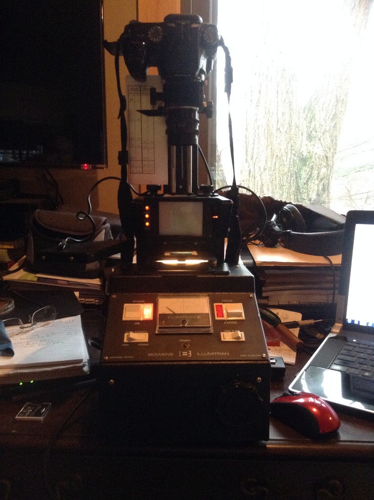

I set up my Bowens Illumitran with my Sony 10MP DSLR and scanned some 35mm slides and 6x7 negatives. I got pretty good results without much manipulation in Photoshop. Because the Illumitran flash sync voltage is too high for a DSLR to handle, I set the camera on 1 second and manually triggered the flash during the exposure. A Wein Safe Sync would remedy my problem with the flash sync voltage. Here are sample digitized slides and negatives. The first image is a 6x7 negative, the next 3 are 35mm slides and the last picture is my Illumitran with a 10MP Sony DSLR and a Bogen 60mm W.A. enlarger lens attached to the bellows.
