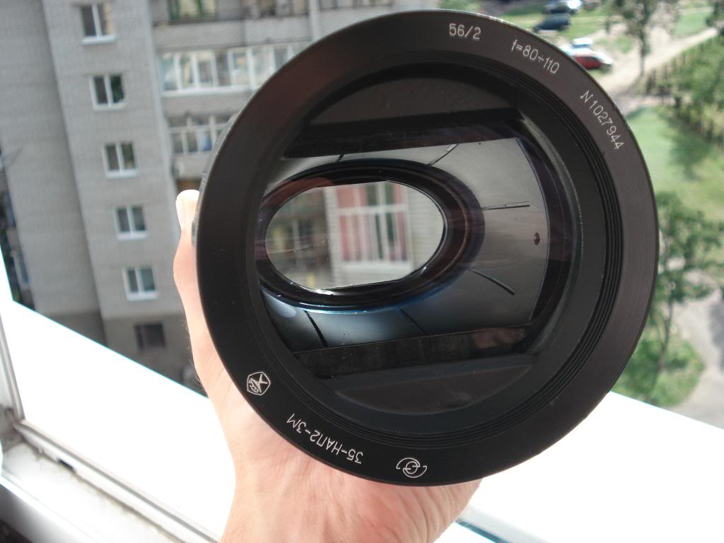

Bought LOMO Anamorphic 35 nap2 3m 56/2 f:80-110 lens
Oct 29, 2006
4,829
İstanbul

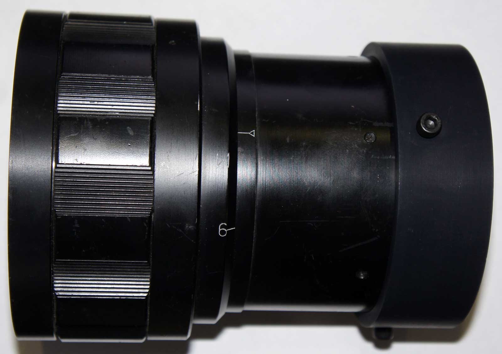

I bought above lens. There are lots of youtube , vimeo videos taken with that lens and it was my last 10 years hero. Finally got it. I think I would be needed an additional lens to attach a film camera but for curiosity how tiny digital cameras uses that lens ? Do I need to find 80-110mm range lens back of the lens. It focuses down to 9 meters , some say anamorphic attachment , some say projector but it cant stop the digital shooters. How do they attach the giant lens in to tiny camera and use it. Big questions for me.

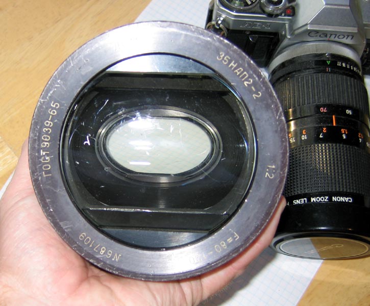

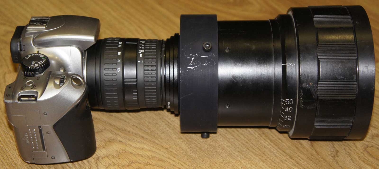

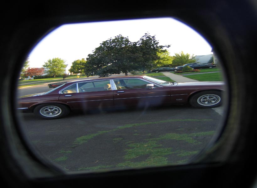

I've not had a chance to really play with it (in the 10 years or so I've had it, yikes!) but it's just like yours - meant to attach on the front of a really big 35mm movie camera lens, so it doesn't have its own tripod socket, and attaching it to a smaller camera's lens is going to be, well, interesting.
I shot two quick test photos with a cheap digital camera (Canon Powershot Pro) back when I got it, just by holding the two up together by hand and shooting... so complete with all sorts of internal reflections with light leaking between the two lenses, and so on
Duncan
The correct orientation:
The incorrect orientation:
Oct 29, 2006
4,829
İstanbul
Wow , it has to be used vertical , I am learning new things every hour. I shocked. Can anyone confirm that and is that a play of digital camera or do these lenses been used vertical ?
frobozz
Feb 19, 2010
1,458
Mundelein, IL, USA
Yes, the lens needs to squeeze things horizontally (squeezing a wide aspect ratio image onto a narrower frame of film) so from the front the front anamorphic element would look vertical. Then during projection the lens is also used in that orientation, so that the image is un-squeezed (expanded) from the narrow width of the film, back to the full width of the original scene. However if you are just looking to make weird images on still film, you can use it any way that creates a look you like!
