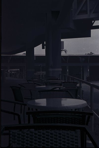

Hi! I'm having problems with some of my negatives, for some reason they look "solarised". I'm using 35mm Neopan 400, D76 developer and Atlas Fixer, all of which I mix on my own. I'm not exactly sure how this happened but its happened twice already. Attached is a sample that has already been scanned. I have other examples but they're too big to be attached as of the moment.
This is pretty much how I develop my films:
>D76 1+1 at 9.5 minutes at 20C, constant agitation for the first 30 seconds then 3 inversions every minute after that.
>running water for 5 minutes
>Stock solution of the Atlas fixer at 20C for 5 minutes
>running water for 5 minutes to wash the film
>hanged to dry
I do all my developing at night by the way
One thing that I've been thinking about is the possibility that this was caused by heat. I have left the camera with film loaded inside my car for long periods of time (2-3 hrs) and here in the Philippines temperature tends to go up quickly, somewhere along 34C and higher.
Would this have been the cause for this? Or would there have been other factors involved?
Any feedback would be much appreciated:smile:

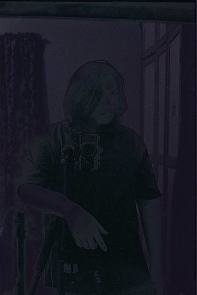

a couple more examples
Additional info. The developer and fixer were mixed around November 2010, I'm not exactly sure if the chemicals have expired due to exposure. They're stored in glass Coca Cola bottles (1 liter) and placed in a corner of my room which does not receive direct sunlight. I'm not exactly sure if that can also be a factor

is your tank completely light proof ?
maybe during your water-rinse, or your developing ... light snuck in through the top ...
solarization usually happens when light strikes emulsion after it has
been developed and before it has been fixed ..
next roll, don't rinse your film as long ( or get stop bath ) and process your film in less light ...
cool effect though!

I'm using a Paterson tank for developing films. I opened only the cover but I didn't take out the funnel.

my guess is that your tank leaks light ... and your long rinse let enough in
to mess-up your film.

It is a pretty cool effect but not when you're trying to understand photography on your own though :D The tank is light proof. This might be my 10th film to be developed in the same tank.

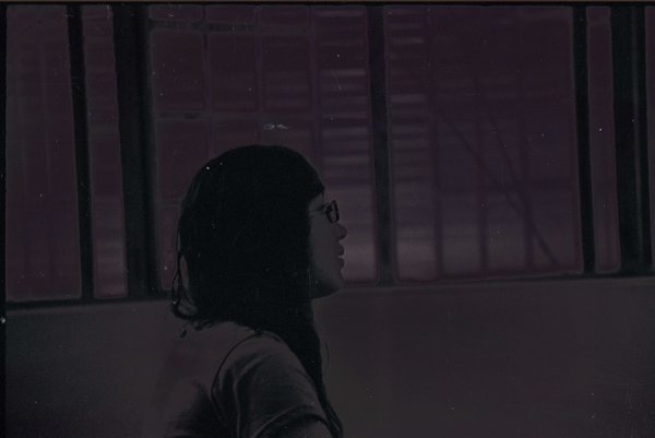

It could be a light leak , but the whole roll should show it right? Here's a couple more from the first time its happened. Mid roll, taken right after each other.
I'm really getting even more confused. :blink:

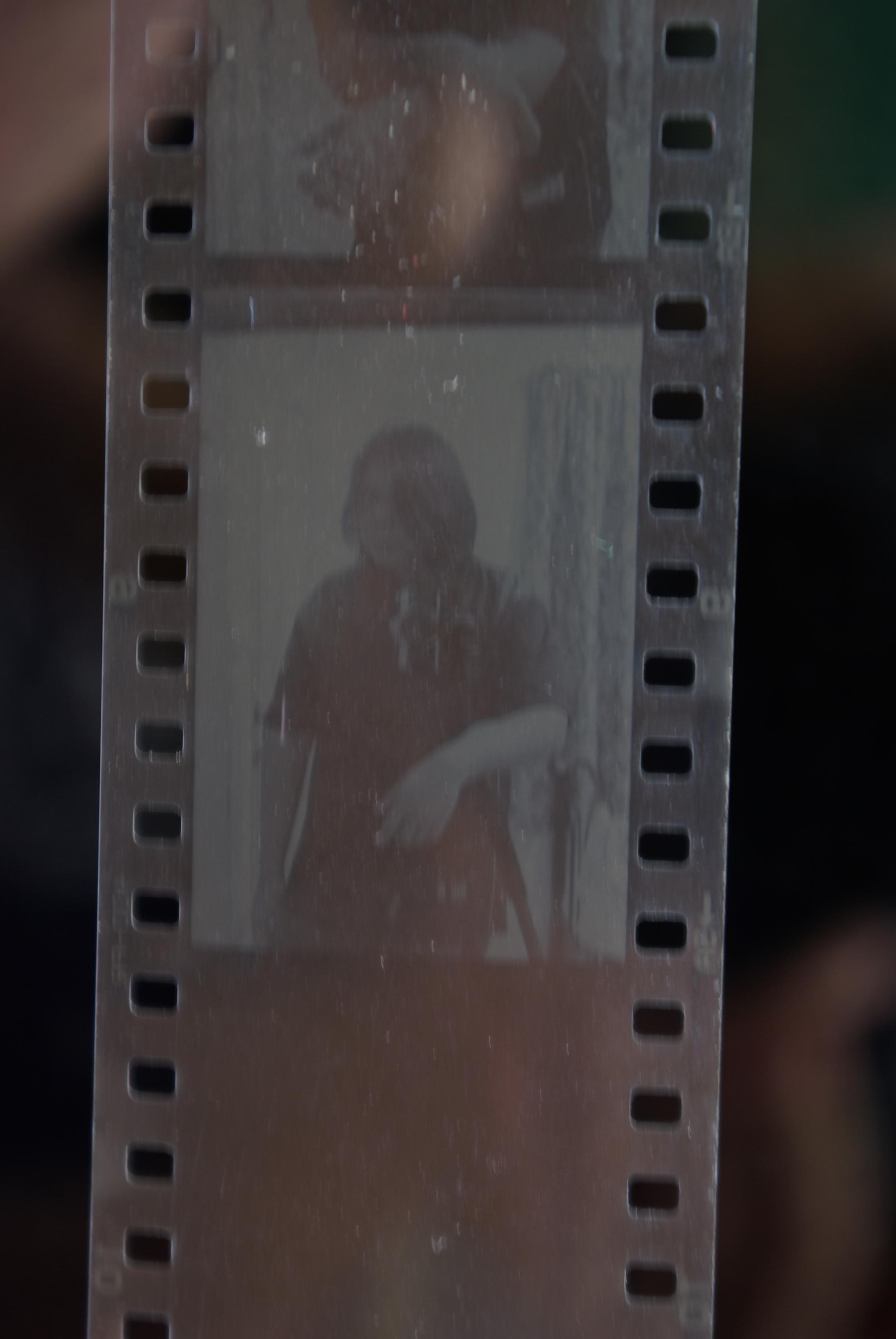

show the negatives to us on a light table or backlit in a window. You appear to be showing prints or reversed scans, but we need to see the negative, sprocket holes and all.
Ill post a couple later, its 12am here already. Thanks!
Hi! I apologize for the really late reply, had to find somebody with a dslr to shoot for me. Anyway, the negatives look like theyre overexposed badly when backlighted however they also like as if it were a slide film when theyre tilted or put against a different background

How much film have you put through this batch of fixer? I've never heard of Atlas fixer. What is it, and what is the formula? I see you're using D76 1+1, which means you're using it one-shot, right? You may have used the fixer past it's capacity. It doesn't look like the samples you provided received adequate fixation.
i think ive gotten to about 6 rolls of HP5+ and about 5 of Neopan

yes it is overexposed, however im not so sure about reciprocity failure though causing the negative to look like a slide film, i never made a shot more than 1 sec long, by the way, the dark background is just a car window, as i understand it even if the negative is overexposed, putting it against a dark background should just make the whole negative dark not show details
would it be possible that temperature changes during development have caused this?
