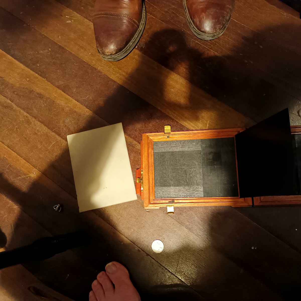

Does anyone use these for wet plate?
Do they need modifying?

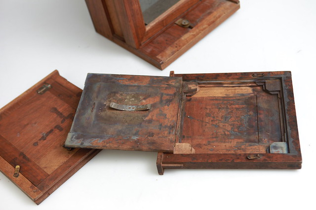

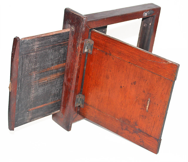

Yours are typical holders for dry plates and (dry) sheet film. Vintage wet plate holders are very hard to find, since the cameras on which they were used are also very rare (before c 1860). The wet plates did rest on metal (mostly silver) threads in the corners of the plateholders, and did not rest or at a minimum on wood.
here's a picture of a vintage holder for wet plates - they have a little door at the back where you insert the plate:
almost all have stain on them from the liquid silver nitrate ....

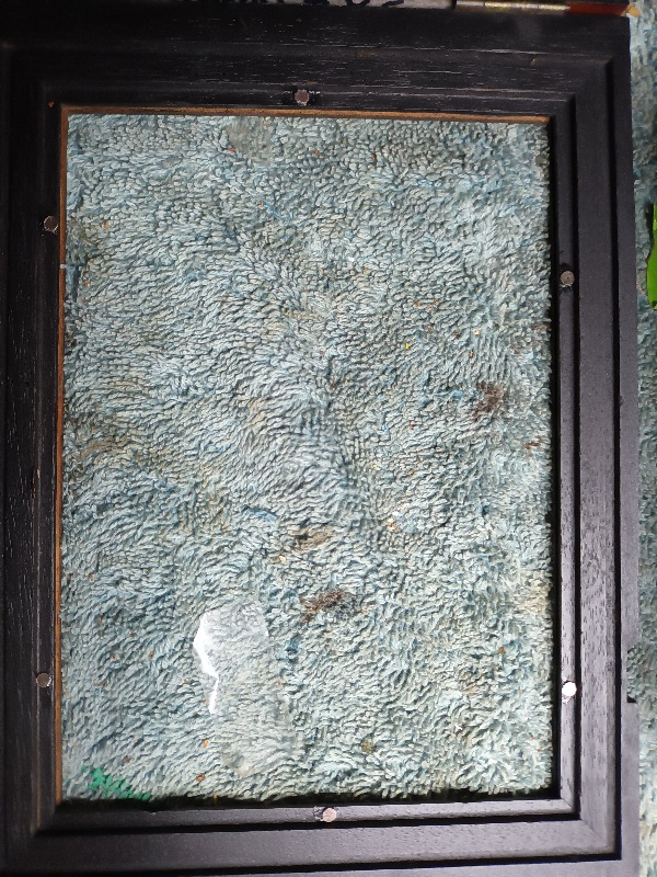

Nowadays people make workarounds with newer / plastic holders:

Coat the points the plate will rest on with black enamel. If you don't they will corrode and make a mess. I painted all the edges along the sides of my holders with black enamel as well. Raw wood is impossible to clean and if it isn't clean the edges of the plate will be very screwed up.
