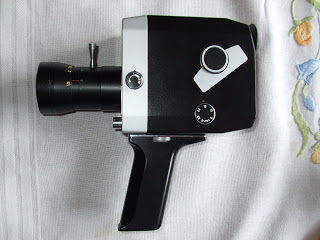

KMZ made two kinds of Super-8 cameras with hand-cranking:
-) models that took Double-Super-8 film on spool (thus 16mm wide)
-) models that took Super-8 cassettes (type Kodak)

I believe there is a Zenit with spring drive that takes super-8 cartridges as in the picture here:
It is that Quarz-series camera from KMZ referred to above.
Actually Zenits are still cameras. But strange enough at some time KMZ put "Zenit" under their logo and put that on that very camera, added by the actual Quarz designation.

KMZ is the manufacturer, Zenit the name of their most popular still-SLR range. (With the exception of one a movie camera out of their Quarz range.)
Back to the topic: I find that spring driven KMZ Quartz with standard S-8 cassette already peculiar, but not that surprising. But that Bell&Howell offered a similar camera really surprised me.
