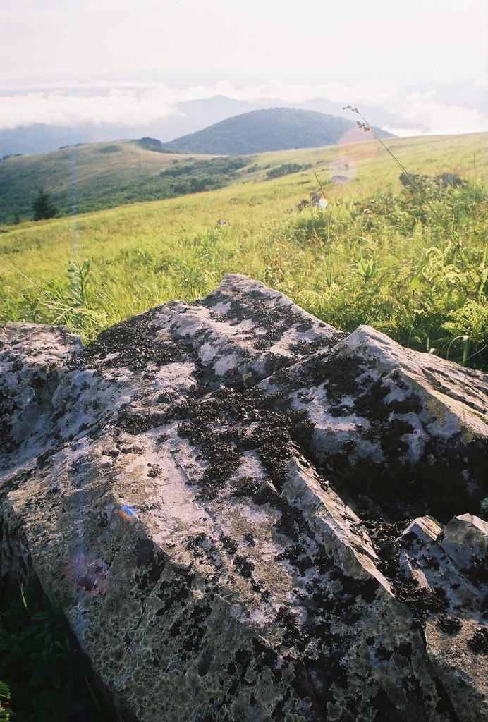

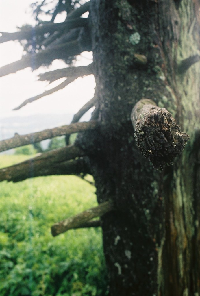

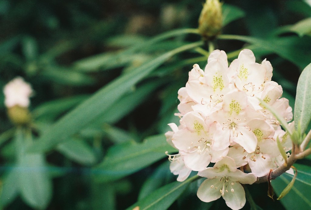

On my last roll, I noticed on the negs a red line throughout the roll. I just got them transferred to CD and it comes out blue. I'm not sure what would have caused it. I'm not sure if it would be chemical related or camera related. Here are a couple of examples.
Thanks for any advice or knowledge.

What camera u using... Looks like a light leak to me... Same spot each frame
heespharm
Dec 8, 2009
527
Yeah a tear in the shutter may do it to... Check ur seals inside ur camera usually around the back of the back lid... Are they gummy? Or degraded?

They seem perfectly fine, nice and fluffy as foam should be. I think I might test another roll through it and see if it happens again. I'm still relatively new to this camera, though I had not had that happen before. I'm wondering if maybe the lens wasn't properly on the camera. I'm used to my Nikons and listen for a click. After messing with the Minolta, it seems you have to slightly turn the lens back like you are taking it off to get that click.
Thank you for the help!
