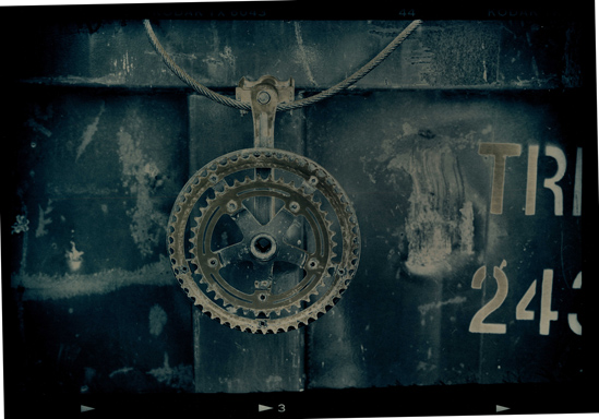

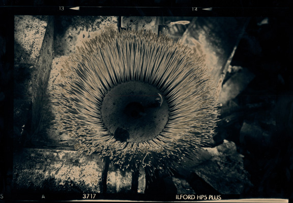

I am mixing a two stop dev metol based for solorizations, and I have tried all the above mentioned .
I could do it today with the iron blue mixes I have tried but they all wash out and from my perspective not permanent.
I am bleaching, sepia, wash gold ---- then the final for the shadows , selenium is nice but gives a warm bias, iron blue is wicked but really unpredictable and washes out.
I have tried every paper that I can think of that will be available in large rolls.
I am kind of stuck on ilford mg4 matt as my preferred paper.
the cold shadows is what is vexing me.
the attachment'swill show you how I envision the final look.
Both are with a two stage development with light blast halfway through, one has more bleaching/sepia and gold at the front end *sunflower* and the other has iron blue heavy at the back end *wheel*
I would be happy it the whole show is between these two looks.
But how do I get the blue in with a permanent dilution.
I think a few years ago I had a conversation with Tim Rudman and at that time we both agreed that though blue would eventually fade away and the silver behind would still be there so something like a semi permanant solution for the shadows.. I will go with this if this is the only way..
