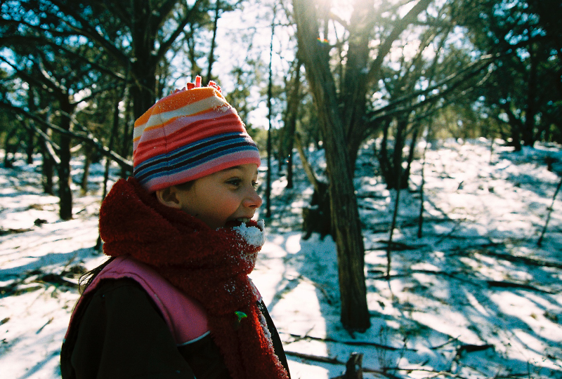

I get similar results with new Portra 400; blue-cast in the shadows. Is this similar to what the OP is getting? Skin tone (also in shadow) seems accurate (though a bit underexposed) but snow in shadow is blueish. This is a basic Walgreens scan.

I see what you are saying, I just don't think it's as bad as a lot of people state. Note, I didn't color correct these scans - this is what the lab gave me. You could easily correct out certain features if you chose. I apologize for the pictures and the slight off-topicness.

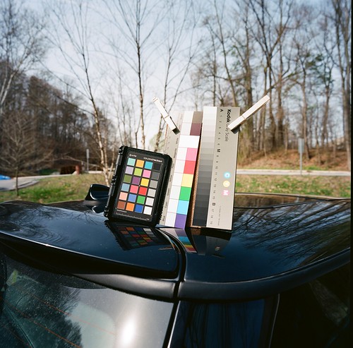

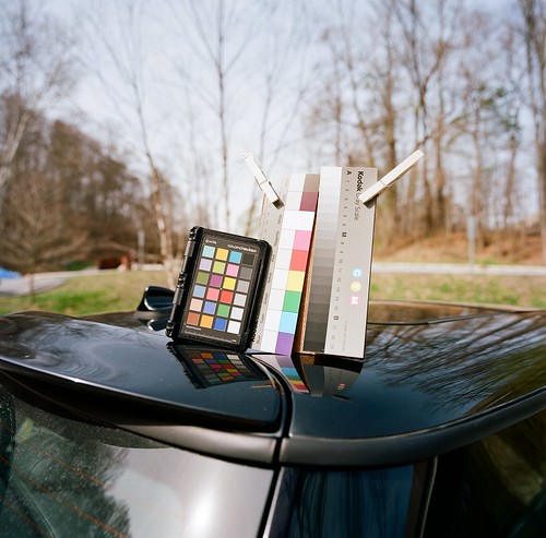

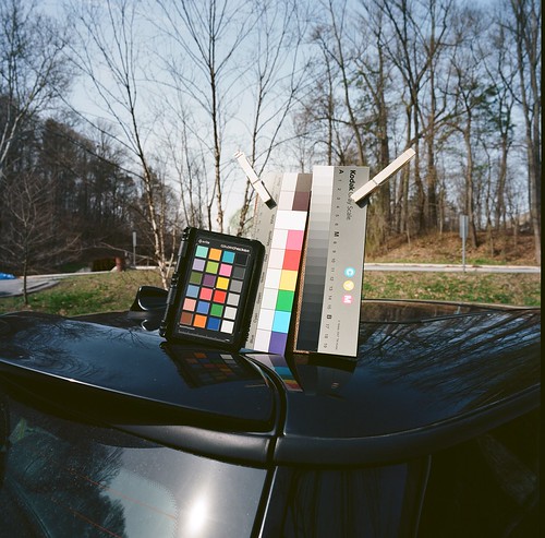

Proper exposure:
Ektar 100 0 by ezwal, on Flickr
3 stops over:
Ektar 100 +3 by ezwal, on Flickr
1 stop under:
Ektar 100 -1 by ezwal, on Flickr
Yes, the black roof of the car looks a bit blue - it is reflecting the sky after all. Barring that, I'd call the 3 stop over shot pretty dang good, more than just passable. The 1 stop under is definitely starting to lose it in the shadows, but by and large, the colors still look pretty good to me.

Tim, were commenting on my shot of the little girl in the snow? If so, thanks.
Sorry, I was commenting on the link to the caterpillar on the plant. Your shot looks good to me. The shadows in your shot look right in my opinion - they really would be blue, and especially noticeable in real life since it's snow.
In this discussion, I think it's important to separate 'shadows' from 'dark tones'. Shadows during the day should be bluish as mentioned - they are lit by indirect lighting during the day, i.e. the blue sky. Dark tones are not necessarily always shadows. I see no reason why dark tones, say a black object in direct sunlight, or midtones on an underexposed negative, should be blue on Ektar.
I'm looking at this on a high end screen. If I reduce the screen gamut to sRGB the scan is still way over-saturated and contrast-stretched past anything reasonable. At higher color gamuts, the image is absurdly exaggerated. This is likely the Walgreens machine being set to compensate for poor quality photography by boosting color saturation and contrast so that the print looks colorful and sharp. I see this a lot, and believe me, a well done scan on your own equipment looks completely different. A lot of the online objections to Ektar 100 are based on scans that were poorly done.
