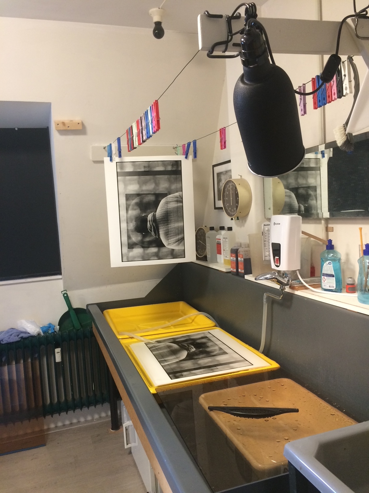

I do the more or less the same: after the final wash, I lay the print on a piece of plexi glass and use the squeegee to get rid of water. What is different is that I then hang the prints to dry. See the attached picture - these are 20x24in. prints (50x60cm). This is in my workspace, I generally go home after printing. The prints dry slow overnight and in the morning there are never waterdrops left.
After that I press them flat and put the prints between acid free carton, to let them rest for a day or so.
I would not put the emulsion side of the wet print in contact with anything.

Do the clothespins leave impressions in the paper'border?

Yes, they do. However, I always trim about 1cm of all four sides of the print. This I do after the pressed prints have been resting between paper. It takes out the tension a sheet of paper has and helps them become totally flat.

@Hilo - I really like your clothespins-on-wires print hangers.
Thanks Don, so do I. I've had four darkrooms since 1980 and this system traveled to each new darkroom. It does not take up any space and it is clean. In my third workspace, I had a separate room of about 3 x 3 meters. After hanging them up, I'd close the door until the next day.
I do workprints on 24 x 30cm paper (a bit larger than A4) and those I do not even wipe the off. The next day they're dry without any marks.
