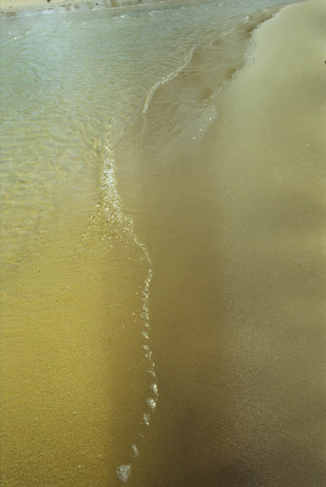

I processed my first roll of Color film (Kodak ultramax 400) with my new tetenol kit. The process seemed to work, but about 1/3rd of the pictures have dark irregular stains. I've included some of examples. Any ideas?

Each of these problems appear to be the result of processing errors. The middle image indicates inadequate developer solution, and this could also be apart of the problem with the others. Agitatoin methods could be apart of the problem.

The first few times I tried C-41, I was trying to keep it at the recommended 102º F. I don't know if my agitation was off or what, but I got some funky results on my 4x5 negatives not dissimilar to what you have there: weird, blotchy color shifts, etc.
Because of the short development times at those temperatures, it really has to be spot on perfect or you greatly increase your chances of screwing up your film from improper agitation, bubbles, etc.

Yes! You are right -it does look like too little developer!
I definitely put in more than enough. Is it possible for the spiral to get caught mid way up the central tube in the tank due to agitation? How do I stop this from happening?

Put a rubber band on the center tube above the reel , that should do the trick.:smile:

If you did not use a prewet before processing, this may be part of the problem. It also looks like insufficient agitation in the first developer and in the bleach bath.
Remember people, a light spot in the positive is a dark spot in the negative and so insufficient developer would give a dark edge in the positive and not a light edge as seen above. Blotches indicate either insufficient agitation or no pre-wet in a drum or tank process.
