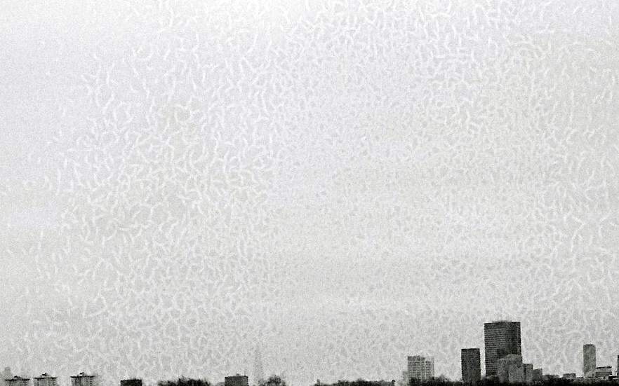

I had some 35mm film developed (Neopan 400) and some of the images have turned out with 'blotches' (see attachment).
I had a previous film developed (Ilford HP5) at the same lab, from the same camera and lens, without any issues.
Initially, I thought that it might be dirt on the lens, as I was taking pictures in a muddy field at one point. But, the blotches are not on all the images and, when they do appear, do not seem to be in the same place each time.
The films were bought from different shops, so I wondered if it might be a storage issue with the Neopan? Or is it a development issue, or something else? The films are well within expiry dates and I didn't pass through x-rays with them. Does anyone recognise what might have caused this?

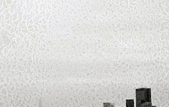

I've attached a detail of the issue (I've enhanced the contrast to show it up better).
Thanks
You appear to have something growing on your film. Do you live in a tropical region and/or is there any possibility the film might have gotten damp, e.g. refrigeration after unsealing the original foil packaging?
Have a close look at the neg and see if you can tell whether the additional density is silver or some other substance on the surface of the film.
Edit: that is definitely a film issue, not a camera issue unless you have a little rainforest going in there.

Looks like a case of reticulation caused by improper processing. Try another roll from the same batch, but not for anything important, and see if it happens again. It could be the lab that processed the film made a chemistry or temperature error, and if so they did not recognize that they had a problem.
Either reticulation, or a problem with condensation.
Its reticulation.
Temperature error during processing.
Simon ILFORD Photo / HARMAN technology Limited :
Reticulation, though inhomogeneous. What makes it interesting.

Yes, the first few images seem to be free from the 'reticulation' (I've learned a new word, thanks). Then it kicks in around image/s 7-10 and continues throughout the film to a greater or lesser degree. One or two images after this appear less or unaffected, but perhaps it is just more obvious on certain types of image.
So, I'm probaly safe using the rest of the batch? I'll probably keep them aside for less 'crucial' work, just in case.
The batch of film is likely ok, but you may want to do some lab shopping. With your current lab, you should show them the film and see if they will work with you in correcting the problem.
Some films are more prone to reticulation than others, I think the Fuji films are among those, but I don't know for certain. If you search reticulation in here there should be lots of information.
Generally, it's caused by sudden temperature changes in processing, either large temp differences between the chems, or, temperature shifts during washing (somewhat more likely).

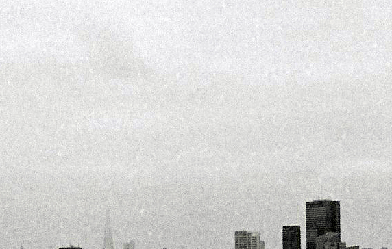

Just for the sake of discussion. Most of the images I've seen online about reticulation seemed to have a more uniform pattern, which is why this seemed odd. These two images were next to each other on the roll (or pretty close), yet one has the issue and the other doesn't. I had also wondered if it was something that the lab did when they scanned the film (although this is something I do have experience with and it seemed odd)?
I did a search through the literature I got on this issue I have not seen any sample showing inhomogeneous reticulation (except for film frozen during processing, but that gives a different, very specific effect).
My guess is that, if a drastic change in chemical or washing water temperature occurred (I'm going with the latter), then a small amount was poured in down the side of the tank, the error quickly realised, the water poured out. Assuming the film was still on the reel at that point, it would account for the odd spacing of the reticulation.
I can picture in my mind what I mean and what I think possibly happened, but I'm not sure I explained it well. I hope you can make sense of that garbled idea!
