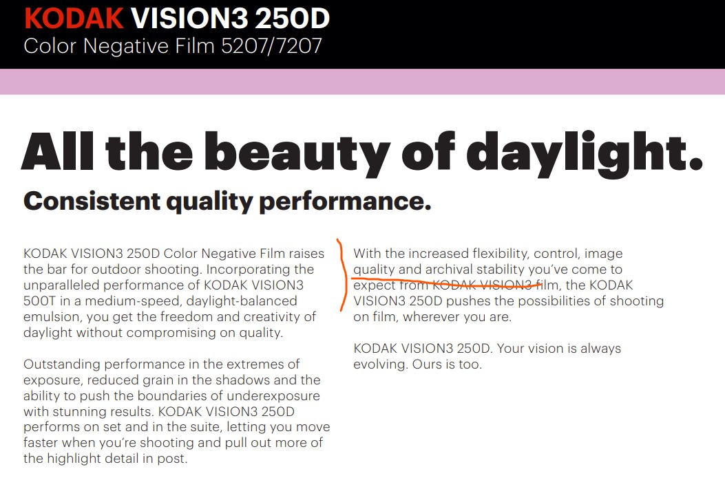

Indeed; it's at least indicated by Kodak as an 'official', albeit it 'alternate' bleach. Still, it has left me wondering why this is the case - does ECN2 film involve stabilization/protection mechanisms that survive a ferricyanide bleach? Or is the truth more prosaic: is ECN2 film intended as an intermediate and simply not intended for long-term storage, and does it not even involves the protection that may be present in C41 films, so that whatever bleach you throw at it is inconsequential in the first place? I have very strong suspicions that the latter may be closer to the truth than the former - but admittedly, nothing to back up that suspicion.
I suspect they designed really stable films in the ECN-2 process.
My other impression is, that E-6 film was never really a love child of Kodak: they much preferred the color accuracy of masked C-41 film, and it did not surprise me at all, that they ditched E100VS at the first sign of real trouble. Volumes must have been very low, too, so their motivation to improve the process must have been very close to zero.
In fact, there seems to be no drama in the VNF-1 and RVNP processes. Why they chose a different approach with E-6 - I don't know...
